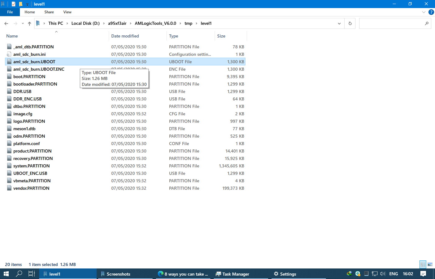

    I dont know how to get the uboot file from my image,when I unpack the image using level 1 I get the following files :<picture>.
    I tried just using sd burn card maker but it didnt work,another problem I dont know which pins to short,the emmc pins are invisible<underneath>.

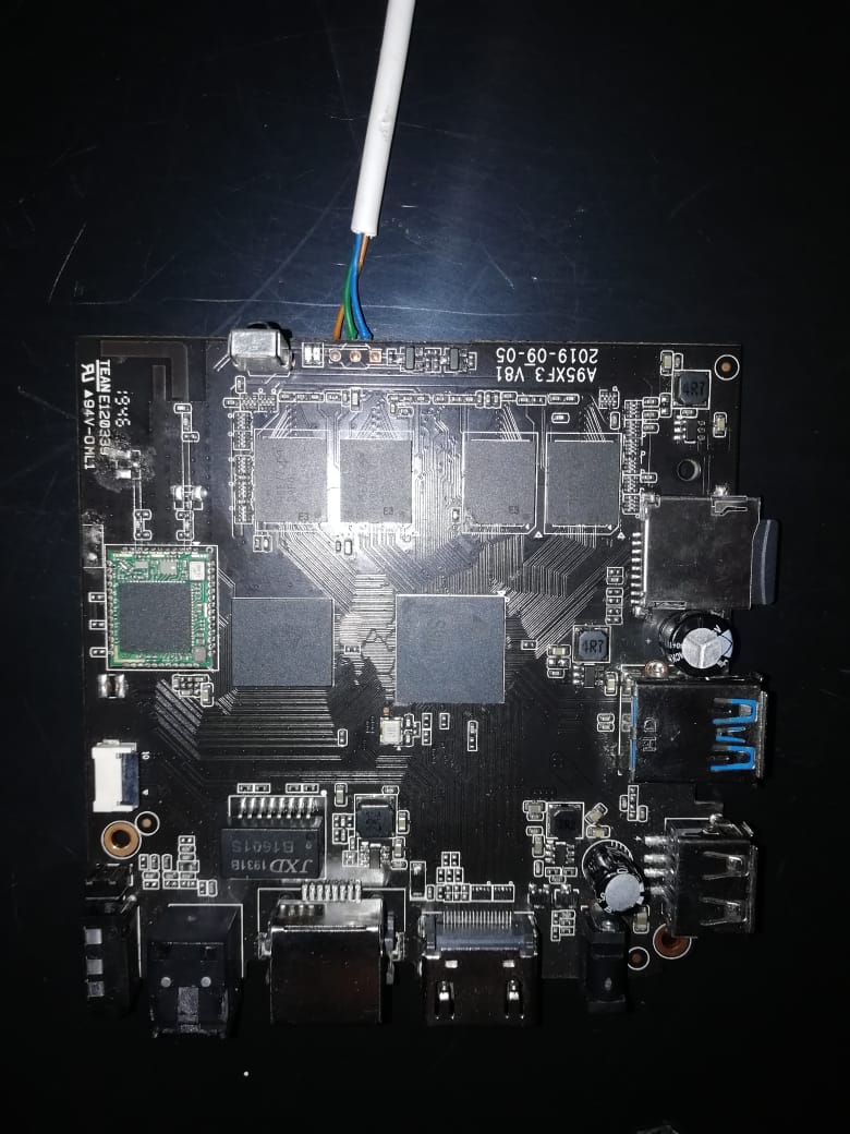

    I tried to connect the box to a desktop comuter with a serial rs232 cable,<Rx Tx Gnd>
    the cable is connected to some 3 solder points on the board <they re not labeled but I believe those are the ones>,but unfortunately I get nothing on putty screen when I power on the device,I tried all wiring combinations,sometimes I get some weird characters when I try a specififc wiring combination.
