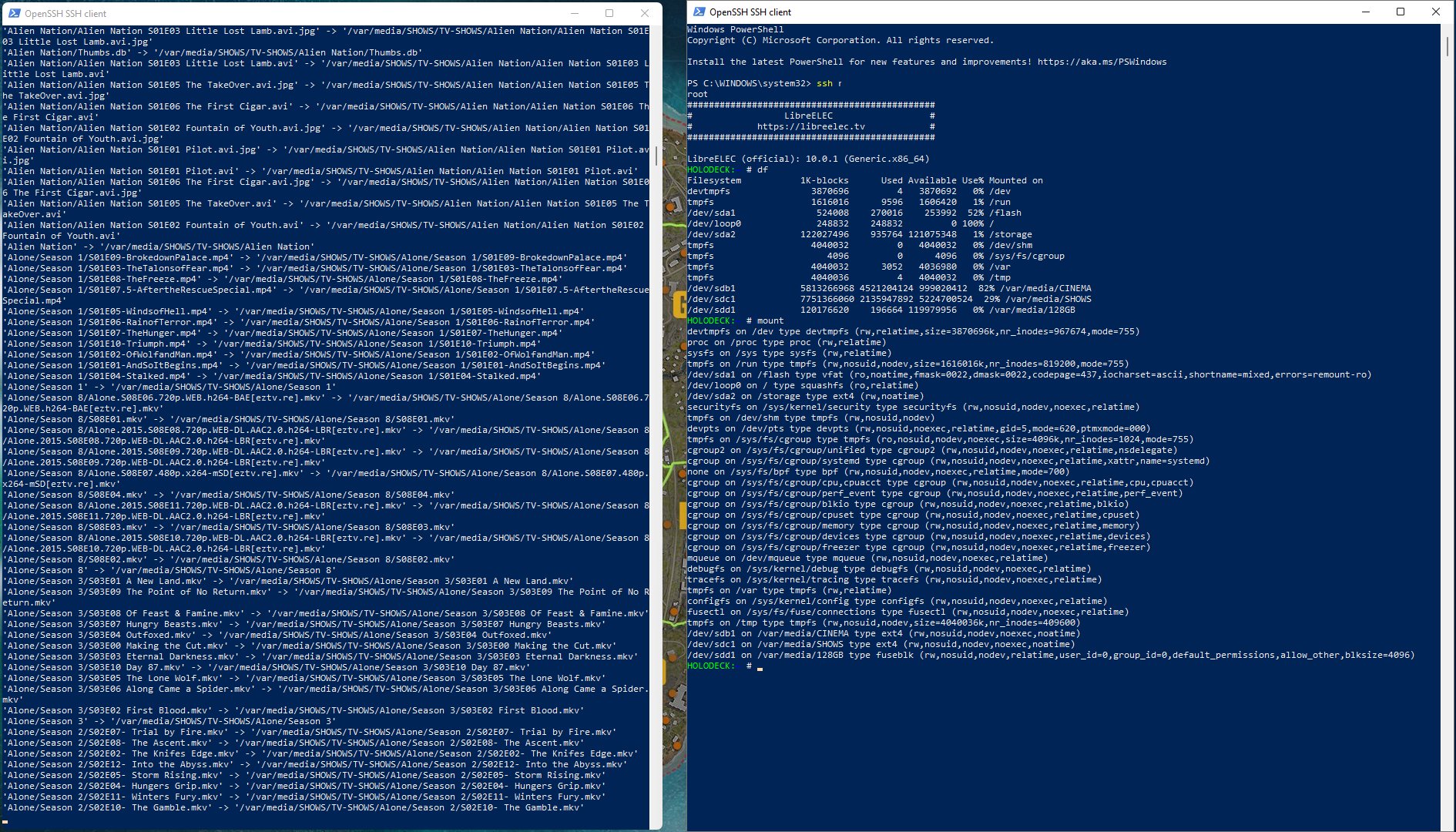

Then the fsck.ext4 gave me this..
HOLODECK:~ # parted -s /dev/sdb mklabel gpt
HOLODECK:~ # parted -s /dev/sdb mkpart primary ext4 2048s 100%
HOLODECK:~ # parted -s /dev/sdb name 1 'MEDIA'
HOLODECK:~ # fsck.ext4 -y /dev/sdb1
e2fsck 1.45.6 (20-Mar-2020)
ext2fs_open2: Bad magic number in super-block
fsck.ext4: Superblock invalid, trying backup blocks...
fsck.ext4: Bad magic number in super-block while trying to open /dev/sdb1
The superblock could not be read or does not describe a valid ext2/ext3/ext4
filesystem. If the device is valid and it really contains an ext2/ext3/ext4
filesystem (and not swap or ufs or something else), then the superblock
is corrupt, and you might try running e2fsck with an alternate superblock:
e2fsck -b 8193 <device>
or
e2fsck -b 32768 <device>
HOLODECK:~ #
Display More
I am thinking that this means what Joe Average was talking about above?? That the HD has some bad areas??

Here is my parted PRINT data..
(parted) print
print
Model: ATA ST8000DM004-2CX1 (scsi)
Disk /dev/sdb: 8.00TB
Sector size (logical/physical): 512B/4096B
Partition Table: gpt
Disk Flags:
Number Start End Size File system Name Flags
1 0.00TB 8.00TB 8.00TB primary
(parted)
Display More
How exactly would I adjust the offset for my particular setup.. I am guessing the 512B/4096B has something to do with it, but it's just a guess...

OK So, I know the drive is good..
How do I alter the command:
... to take into account the full 8TB of the drive??
Here is what I am seeing when I run the afore line..
