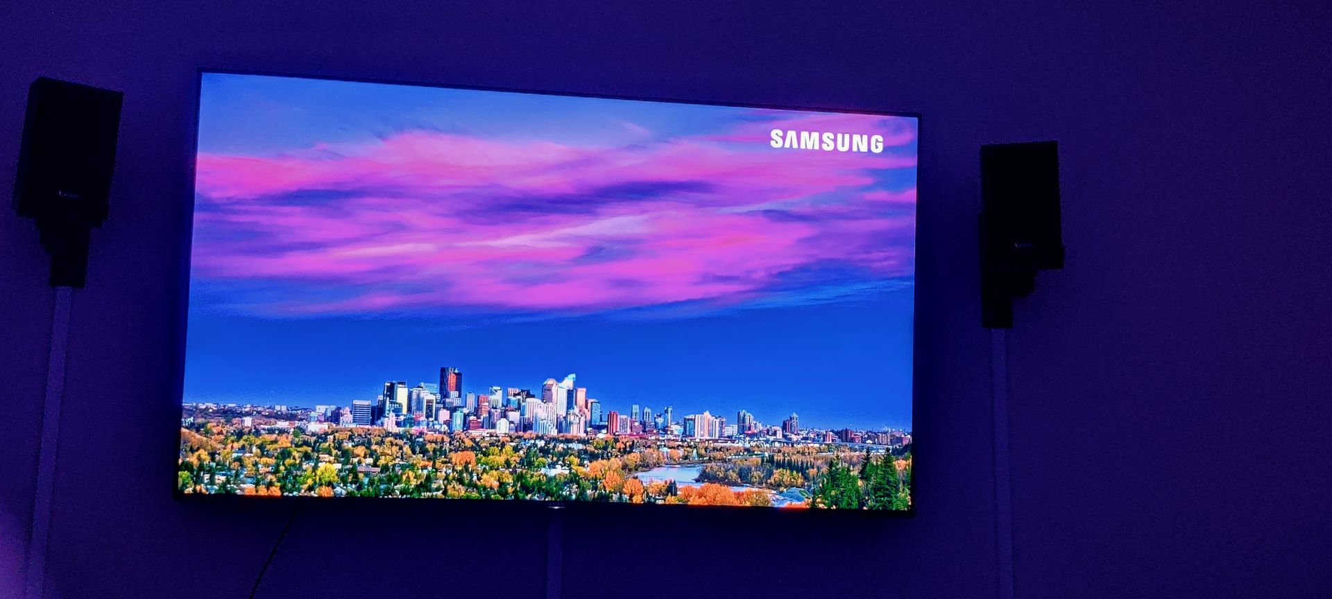

VLC on TV:

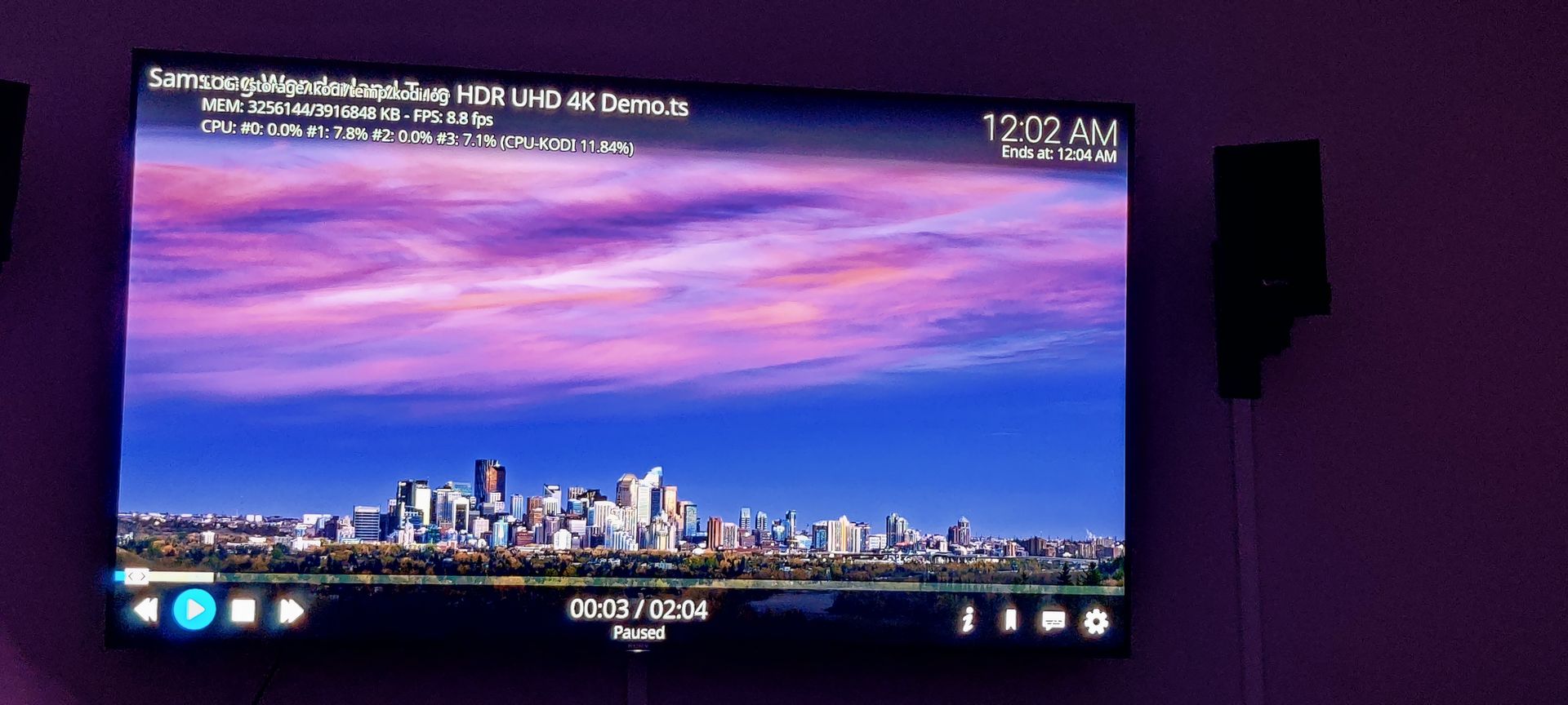

Kodi, file on RPI:
Settings on the TV are the same for both connections. The RPI goes directly into the 4k HDMI Port (HDMI 2).
Apparently Kodi doesn't like TS files. Samsung Wonderland Two HDR UHD 4K Demo.ts is exactly what I downloaded. Played it directly on my TV using VLC and it looked pretty good (the TV says HDR is enabled).
Kodi starts the video, but doesn't play it (it's stuck on the first frame). As of now it's frozen up. Kodi doesn't react to remote control inputs nor SSH. Debug is enable any none of the numbers are changing. The frame doesn't look the same as on the TV though. Seems "washed out" a bit.

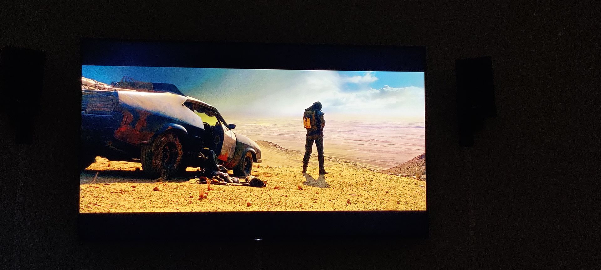

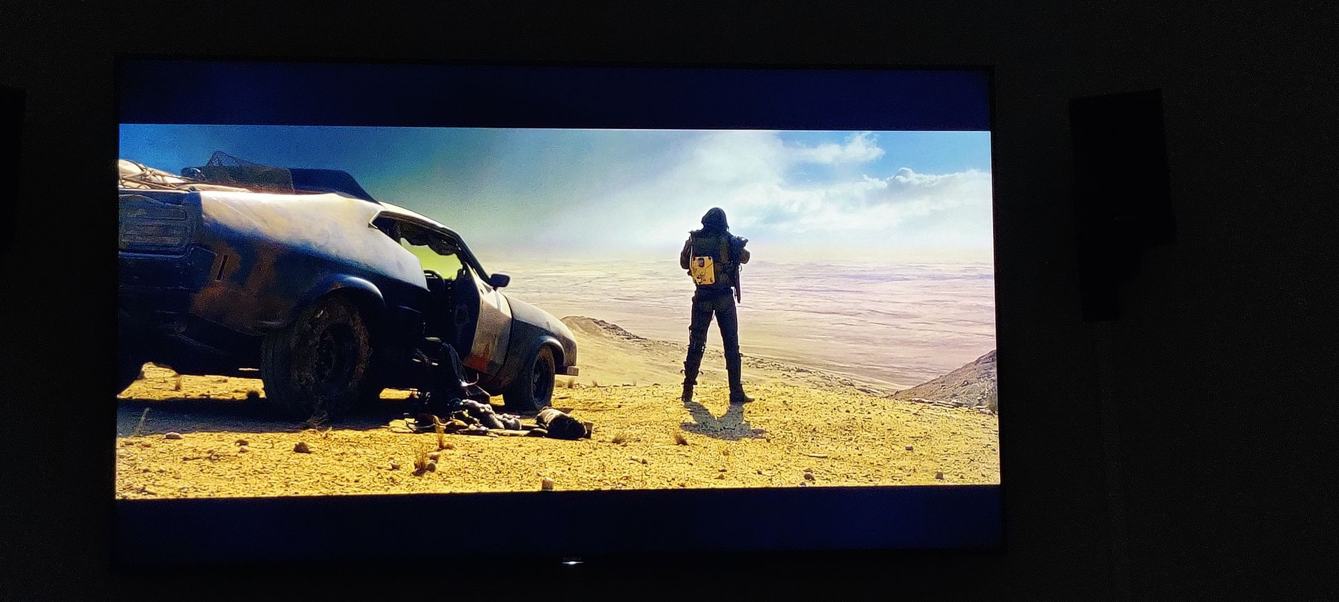

Tried another movie where the difference also becomes clear:
Kodi:
Plex:

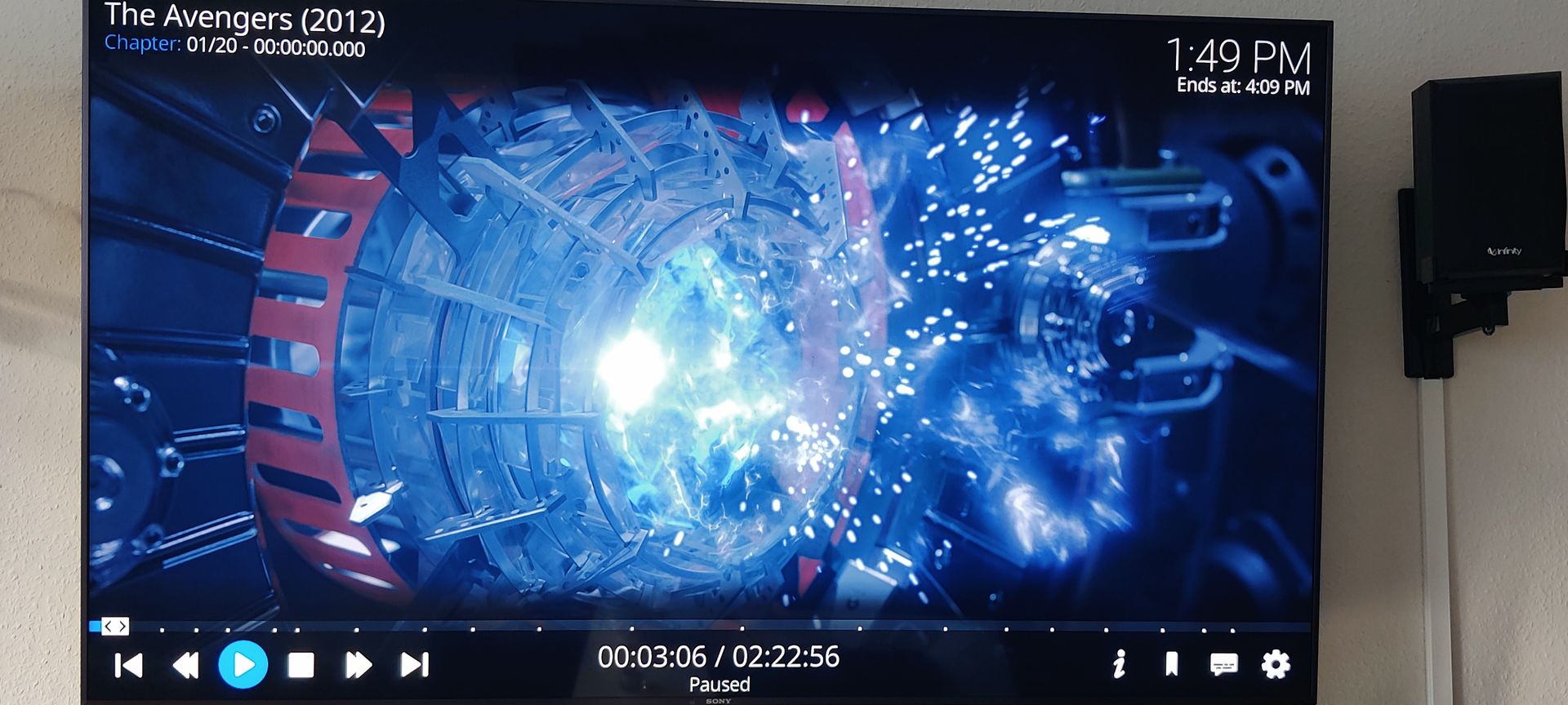

Thanks for this build! I updated from the latest nightly (LibreELEC-RPi4.arm-9.80-nightly-20210210-06bafb5.img.gz), which was installed freshly to the SD card. I tested a few video files via LAN. Audio was fine. In theory, HDR was being played (according to my Sony KD65FX9005), but there was a clear difference in image quality comparing the same scene being played via Plex on my TV itself and Kodi.

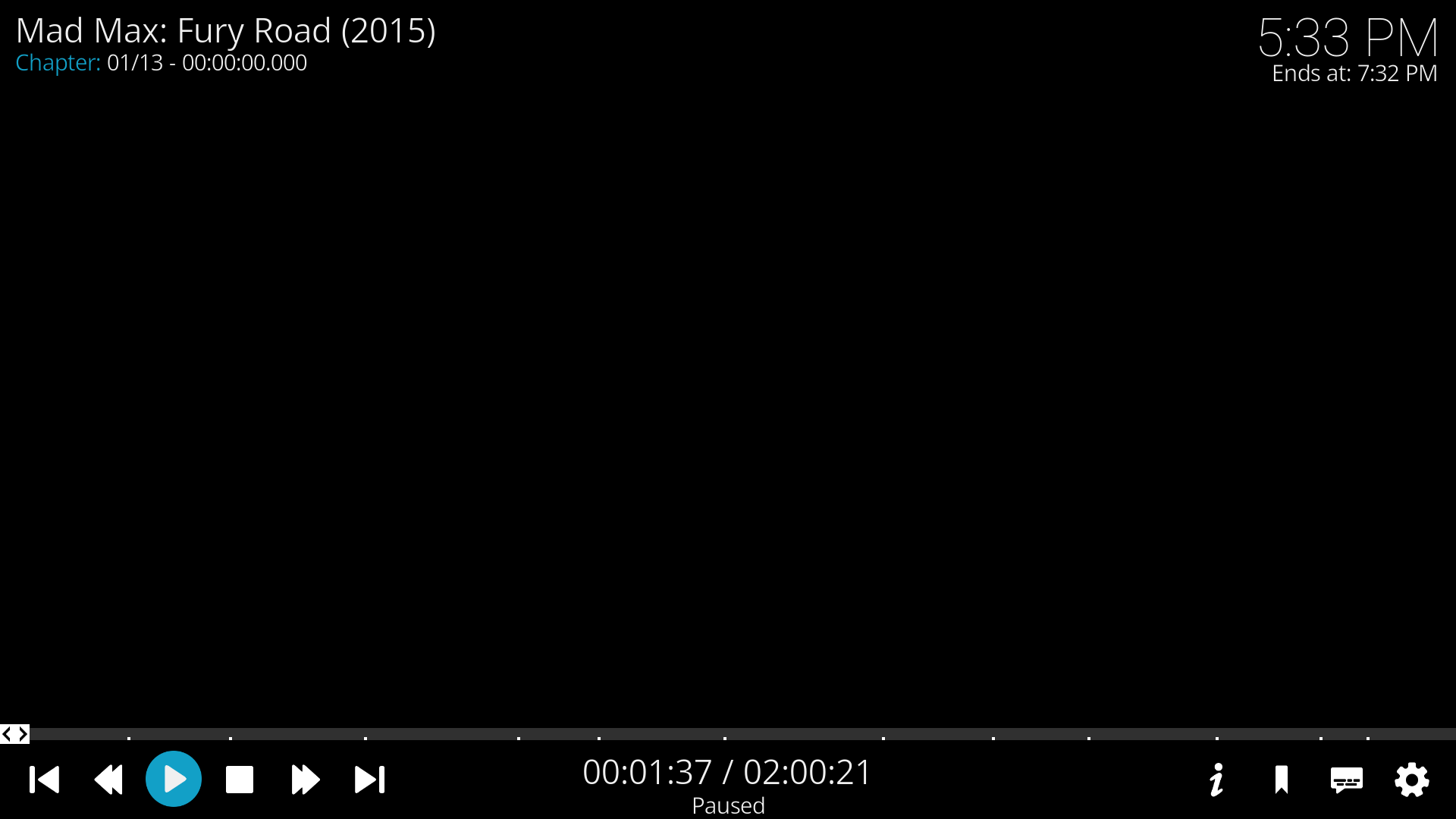

Unfortuantely, the screenshot function doesn't work properly:

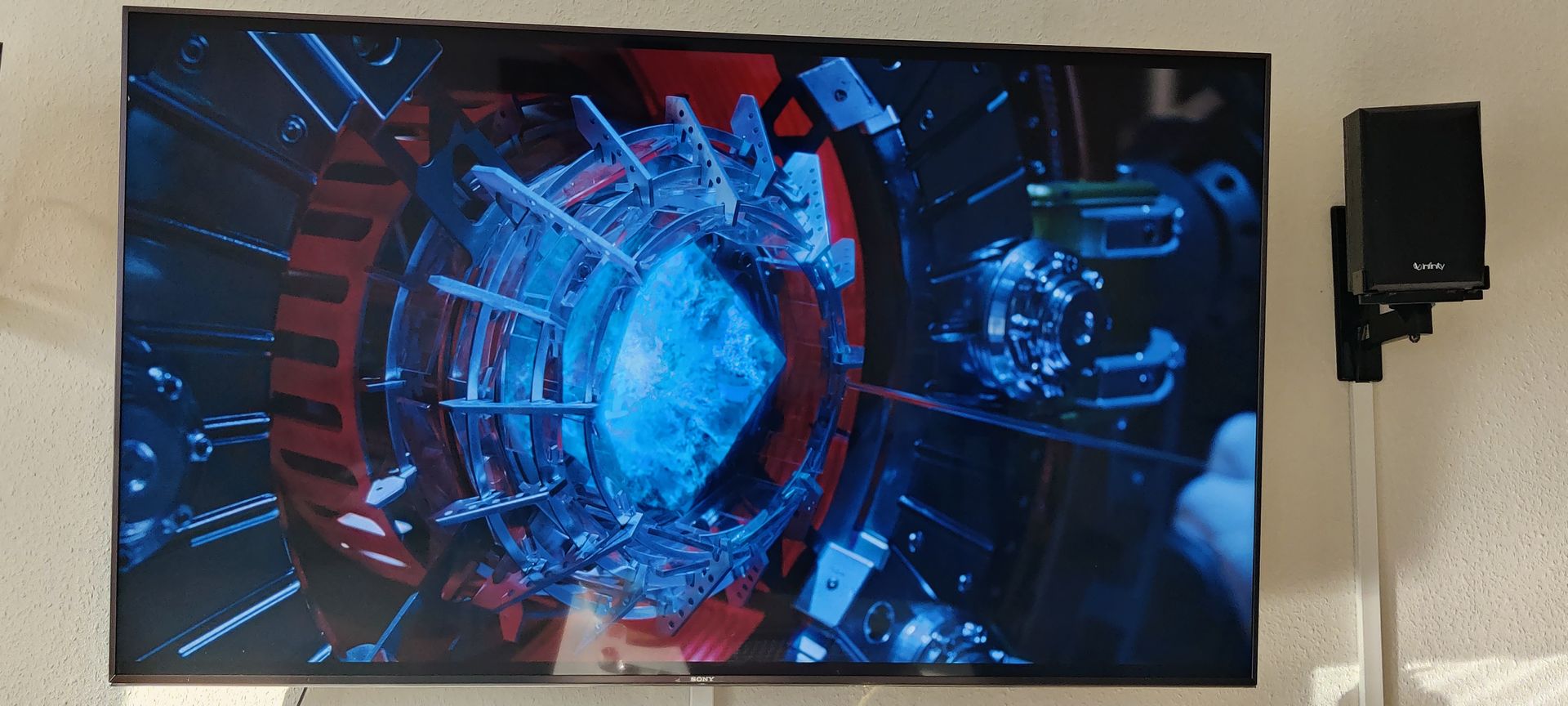

Using my phone, I made this picture from Kodi:
And from Plex running directly on my TV:
The difference is visible on the pictures, though it is greater in real life.
