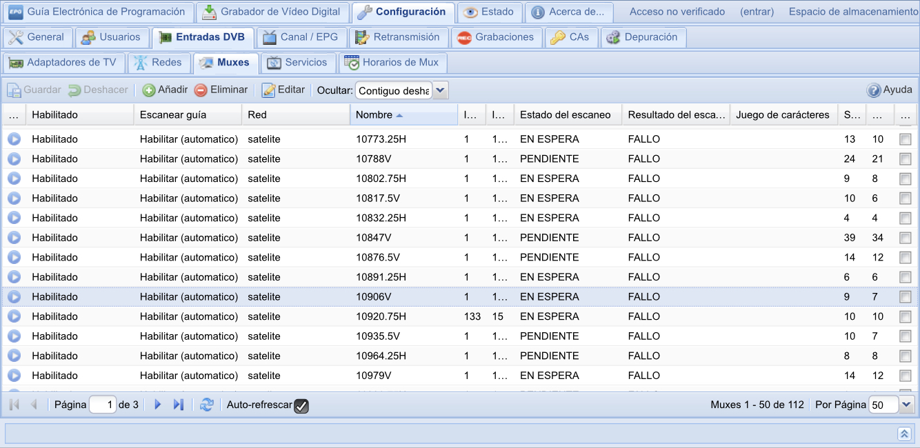

    This is my config. All muxes say
    Scan State PENDING OR WAITING
    Scan Result FAILED
    As I said before, could be the error due to a fail in sat antena ?
