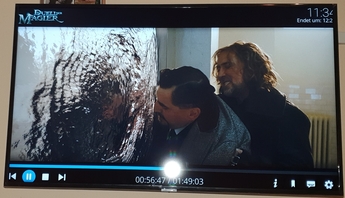

Hello
I have the picture with Kodi calibrated so that it is adapted to my TV.
Only in play mode it does not fit and cannot be corrected.
(see attachment)
Can anything be done about it?
