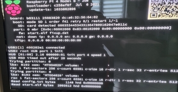

Also with the "LibreELEC-RPi4.arm-11.0-nightly-20211010-4ec2af6.img.gz" my Raspi 4 does not boot.
The start.elf is found (see attachment), then comes the coloured square and then a black screen. That was it.
I have now done some tests.
My other Raspi 4 runs the Nightly libreelec.
Otherwise all images work: Libreelec 10.0.0 and Rapbian via USB and sd card.
