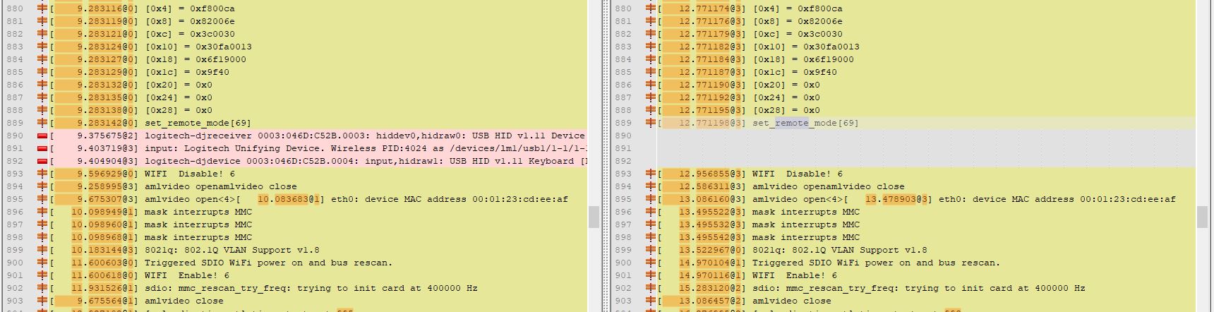

    I'm going crazy with my MXIII Plus, 2GB RAM 8GB ROM.
    I tried several images, in some the wifi and bluetooth work but the remote control does not work, in others it works only the ethernet really bad but then the remote control works (LibreELEC-MXIII-Plus.arm-9.2.8.3.img.gz).
    Only the remote control doesn't works with this: LibreELEC-n200-AP6330_2G.arm-9.2.8.3.img.gz, how do i retrieve the configuration from the other image? Is it a question of a different kernel?
    I don't know what to do anymore, this is the result of the dmesg with both the images.
    Comparing the dmesg in the image on the left is the version with the remote control working (MXIII Plus), on the right no (n200), but the external keyboard even if I don't see it at that point works with both.
    The dtb of both images looks the same to me, is there something different in the filesystem?
