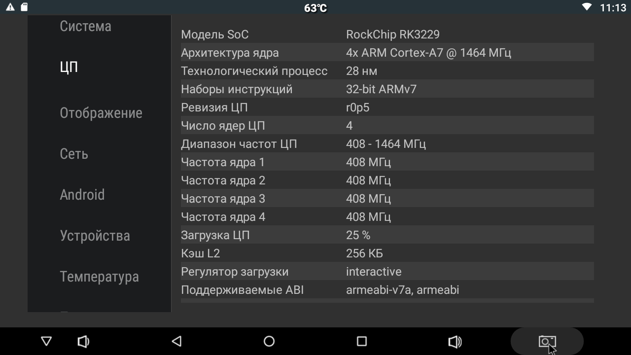

in case of RK3229 vs. RK3228 you will only really know it, when you remove the heatsink from the cpu and look at the actual chip.

What means nothing ... android didn't boot up either? With the exact device? I'm currently watching TV with it .... There is something I forgot to mention: Some people might have an RK3228(A/B) without even knowing it ... they are sold as RK3229 too. These current images won't boot on these hardware ... I just found found a way to support these too ... is going to come
RK3229. The blue LED is on and nothing is loading. If you remove the SD card, the android is loaded.

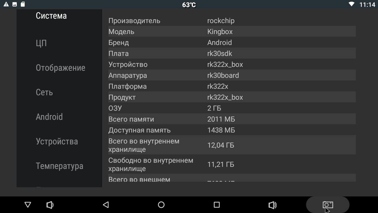

HK1 mini - 2GB RAM, SSV6051 Wifi
