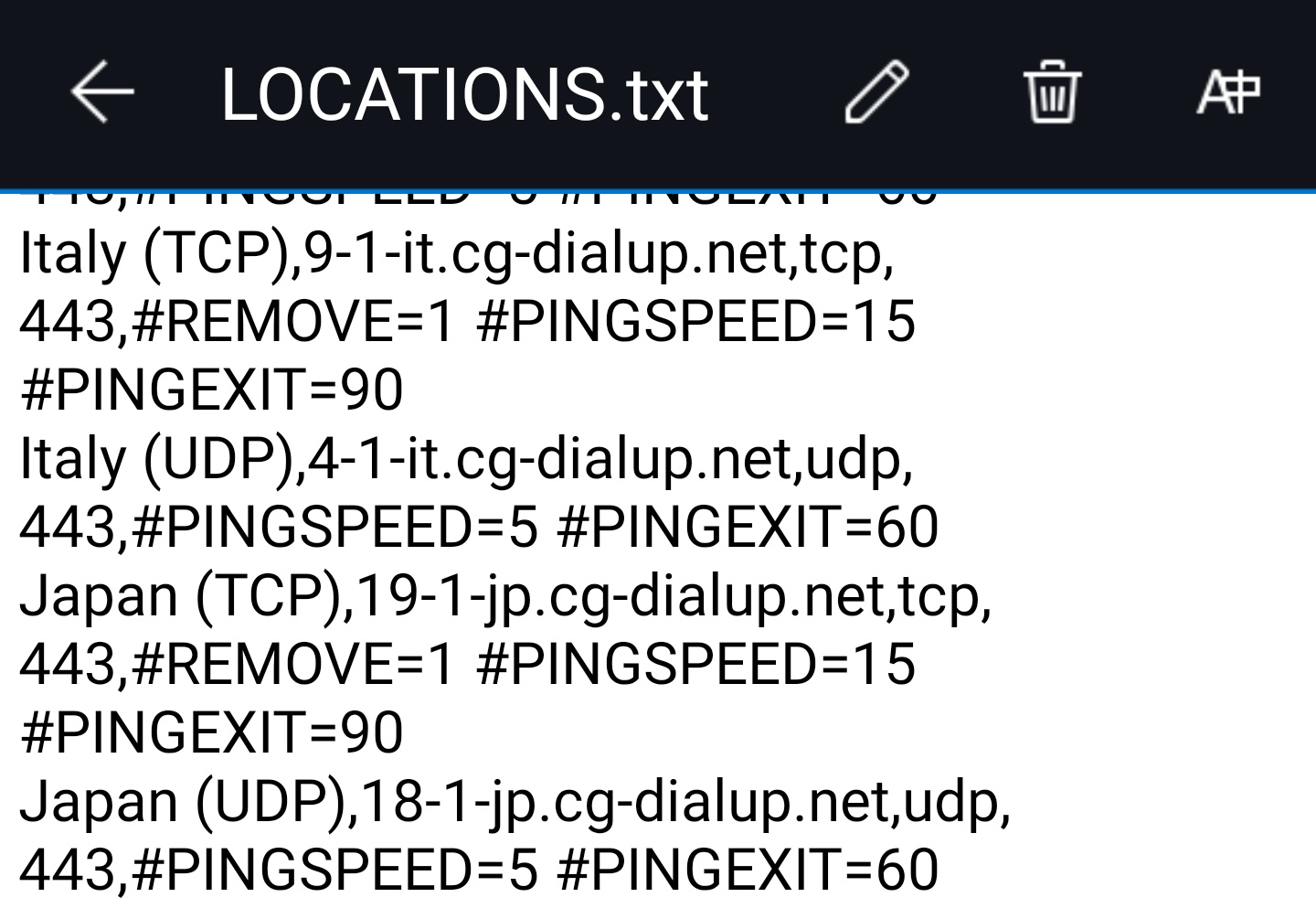

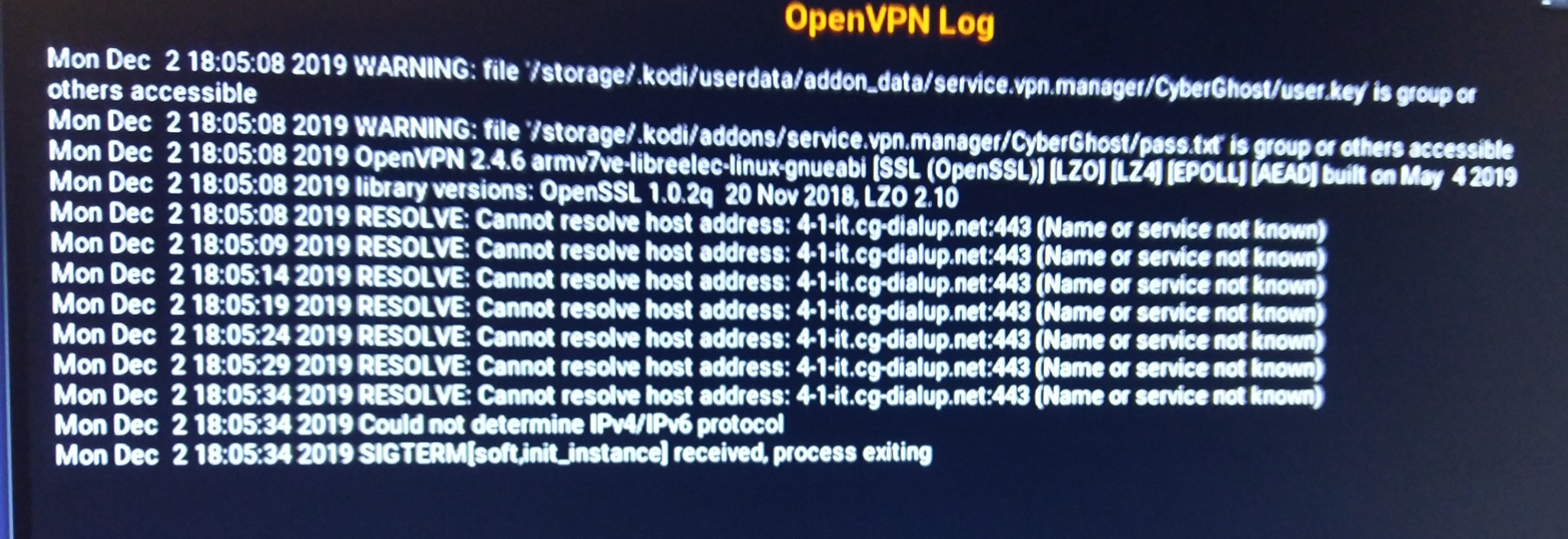

    Hi Zomboided, I hope you can help me at least, because I wouldn't know what to do. For at least a week I have a problem with the Cyberghost vpn connection to the Italian server with libreelec. In practice, all the credentials and certificates downloaded from the Cyberghost website are ok and up to date, I can enter without errors and connect to all the vpn servers I've tried except the Italian one. I asked Cyberghost for help but even they don't know what the problem is, they told me to reinstall the addon and the credentials, which I did a lot of times but nothing ... I don't understand why I just can't connect to the Italian server . It says the address is not known or incorrect, but in reality the credentials are updated. I believe there is a problem of conflict between the stored addresses on open vpn managers and those of the provider vpn cyberghost. The fact is that if I try to manually change the file locations.txt by entering the server address vpn italia (updated) it still cannot connect. I am attaching the error screen in case I know what the problem may be. Thanks again for the availability. A greating
