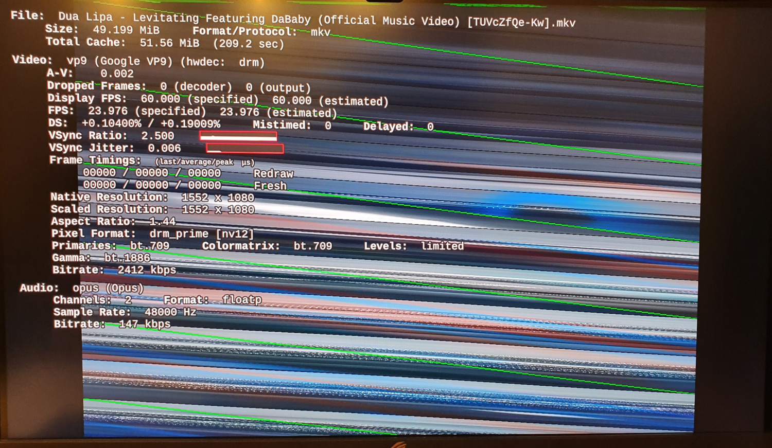

should improve VP9 decoding speed
ffmpeg VP9 decoding test shows some improvement, but not much, can't reach 30fps for 4K HDR sample.
Codeffmpeg -hide_banner -hwaccel drm -hwaccel_output_format drm_prime -i COSTA.RICA.vp9.2160p60.HDR.mkv -f null - frame= 1644 fps= 28 q=-0.0 Lsize=N/A time=00:00:27.46 bitrate=N/A speed=0.47xMaybe bottleneck is elsewhere, or VP9 decoder clocks aren't set to 576MHz.

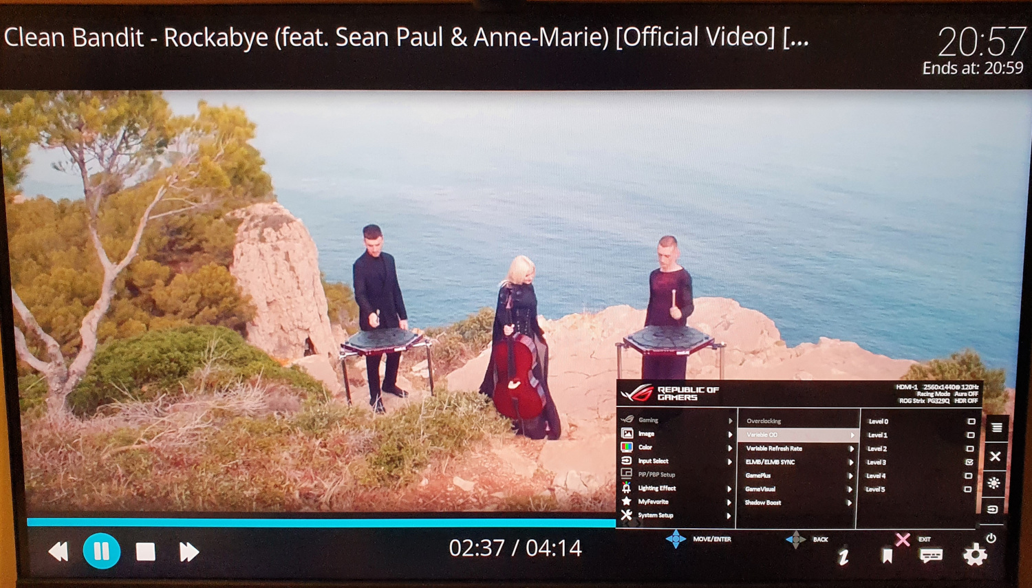

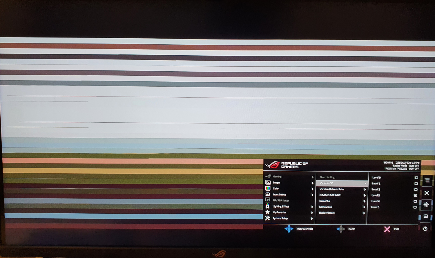

Yes, HDR output works, my monitor does switch modes!
Colors look very similar for both SDR and HDR versions of Costa.Rica VP9 sample.
But obviosly 8-bit output, heavy banding in gradients while playing HDR.Here are photos of monitor OSD with some technical data.
HDR:

I suppose you're testing this on non-HDR capable screen? During writing 10-bit HDMI output support, I noticed that HW does proper downscale from 10-bit to 8-bit, but that is probably just averaging. There is HW for applying HDR tonemapping, but I have no idea how to use it nor how to integrate it in DRM framework.
Yes, my H6 box is connected to 12-year old 1080p SDR TV, used to be rather high-end. According to EDID it supports 10bit and 12bit colors, but its definitely way too ancient for HDR.
Can test on modern HDR capable monitor if needed, but guess not much point until H6 HDMI driver gains ability to send HDR metadata to display.
can try this patch to make VP9 10-bit work (downscaled to 8-bit)
Tested this patch on both master(cma=1024M) and iommu branch.
Looking good, not a single error in logs!
Works for every 8bit and 10bit VP9 sample I've got, all from Youtube anyway.
10bit HDR plays with washed out colors, but thats probably expected, H6 HDMI hardware tonemapping most likely isn't implemented yet.Also tested bare decoding speed with ffmpeg commandline:
Typical 4K 8bit VP9 decodes at ~32 FPS, and 4K 10bit HDR is slower at ~24FPS. Probably ffmpeg decode path isn't 100% optimized yet.
Allwinner datasheet only promises "VP9 Profile 0/2 4K@30fps", so 4K@60 most likely isn't achievable on H6.I'd say this VP9 fix patch should go to master, nice job!
