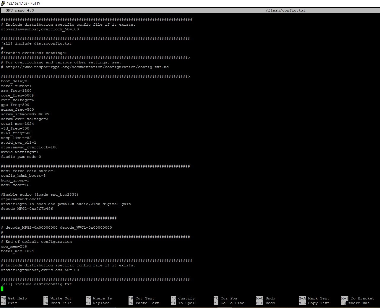

That's the fix. I put "hdmi_drive=1" back in the config.txt and the audio source is sticking across Samba "Movie" shares and "Live TV" video.

Hdmi-Drive=1 definitely kills audio through HDMI.
However, trying it on a USB drive did the same thing. In system settings whenever I play any type of video the default audio source changes from my "Boss DAC" to "pi:HDMI". When I try forcing the audio source change back during (or even when I don't have a video playing) I can hear the audio move from the DAC-to-Demon AVR speaker back to HDMI-to-TV speakers.

Allo Boss DAC - set up properly in config text file (see attached)
