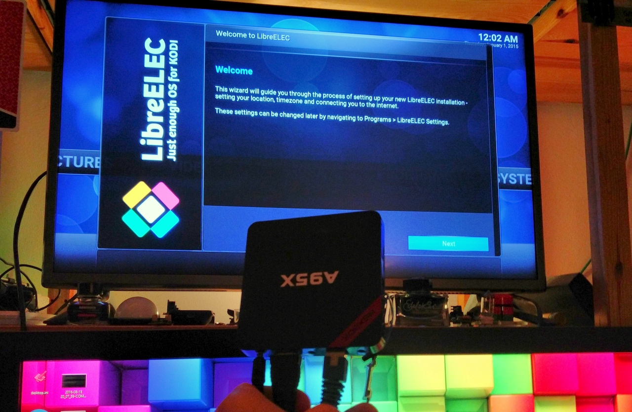

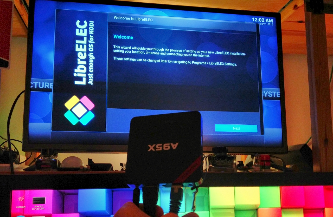

    Just got myself an A95x (S905X, 2/8) and I was wondering if there is anything I can help you with to get LE tested and running on that box. I have started digging a little bit to get roughly familiar with the hardware and how the boot process works in general.
    So far I got the S905 TWRP patched up (used kernel from the stock recovery partition, fixed usb modules) so it boots on the S905X and hooked up a serial adapter so I get into u-boot and can get you full boot logs, segfaults, kernel panics - whatever helps. Some pictures: xD5Ko9
    So if you need some remote debugging, let me know. I would like to help out.
