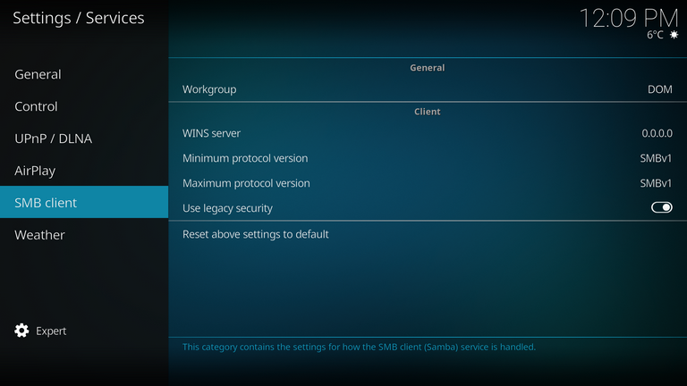

Here I wanted to take a screenshot, but it turned out that my OPi always creates a picture without an image: a 6kb .png file and a black screen inside is blank. I ask you to consider this as another mistake.
I bring the screen settings from another PC, because they are the same, as I said.
