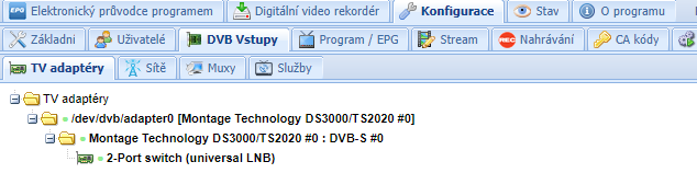

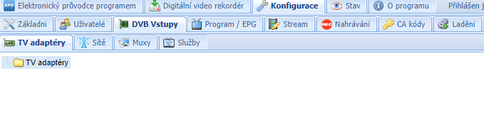

DVB drivers from the latest kernel - NO DEVICE IN TVHEADEND
DMESG
Display More[ 450.413685] usb 1-1.3: new high-speed USB device number 6 using dwc_otg [ 450.505043] usb 1-1.3: New USB device found, idVendor=0ccd, idProduct=0105, bcdDevice= 0.00 [ 450.505073] usb 1-1.3: New USB device strings: Mfr=1, Product=2, SerialNumber=3 [ 450.505090] usb 1-1.3: Product: TERRATEC USB Tuner [ 450.505106] usb 1-1.3: Manufacturer: Tevii [ 450.505123] usb 1-1.3: SerialNumber: 000000031 [ 450.703749] usb 1-1.3: dvb_usb_v2: found a 'Terratec Cinergy S2 Rev.4' in warm state [ 450.704572] usb 1-1.3: dvb_usb_v2: will pass the complete MPEG2 transport stream to the software demuxer [ 450.704671] dvbdev: DVB: registering new adapter (Terratec Cinergy S2 Rev.4) [ 450.704700] usb 1-1.3: media controller created [ 450.706094] usb 1-1.3: dvb_usb_v2: MAC address: ff:ff:ff:ff:ff:ff [ 450.709869] dvbdev: dvb_create_media_entity: media entity 'dvb-demux' registered. [ 450.726988] m88ds3103 3-0068: Unknown device. Chip_id=7f [ 450.736060] dw2102: su3000_identify_state [ 450.736084] dvb-usb: found a 'Terratec Cinergy S2 USB BOX' in warm state. [ 450.736116] dw2102: su3000_power_ctrl: 1, initialized 0 [ 450.737053] dvb-usb: will pass the complete MPEG2 transport stream to the software demuxer. [ 450.738637] dvbdev: DVB: registering new adapter (Terratec Cinergy S2 USB BOX) [ 450.738681] usb 1-1.3: media controller created [ 450.743356] dvb-usb: MAC address: bc:ea:2b:46:13:a5 [ 450.747504] dvbdev: dvb_create_media_entity: media entity 'dvb-demux' registered. [ 451.082846] m88ds3103 3-0068: Unknown device. Chip_id=52 [ 451.083070] dvb-usb: no frontend was attached by 'Terratec Cinergy S2 USB BOX' [ 451.083466] Registered IR keymap rc-tt-1500 [ 451.083837] rc rc0: Terratec Cinergy S2 USB BOX as /devices/platform/soc/3f980000.usb/usb1/1-1/1-1.3/rc/rc0 [ 451.084252] input: Terratec Cinergy S2 USB BOX as /devices/platform/soc/3f980000.usb/usb1/1-1/1-1.3/rc/rc0/input8 [ 451.084970] rc rc0: lirc_dev: driver dw2102 registered at minor = 0, scancode receiver, no transmitter [ 451.084987] dvb-usb: schedule remote query interval to 250 msecs. [ 451.085014] dw2102: su3000_power_ctrl: 0, initialized 1 [ 451.085027] dvb-usb: Terratec Cinergy S2 USB BOX successfully initialized and connected.TVHEADEND
DVB drivers from CrazyCat - DEVICE IN TVHEADEND OK, BUT LOTS OF TRANSPONDERS NOT WORK

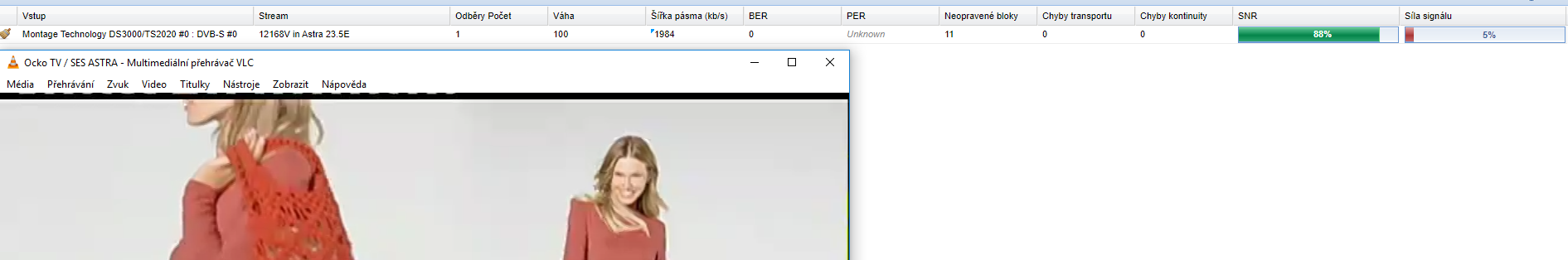

Astra 23,5°E, 12168,V,27500,3/4,DVB-S - WORKS
Astra 23,5°E, 12388,H,29900,2/3,DVB-S2 / 8PSK - NOT WORK

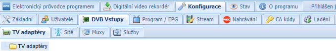

LE Default drivers - NO DEVICE IN TVHEADEND
DMESG
Display More[ 30.049832] usb 1-1.3: new high-speed USB device number 6 using dwc_otg [ 30.141299] usb 1-1.3: New USB device found, idVendor=0ccd, idProduct=0105, bcdDevice= 0.00 [ 30.141329] usb 1-1.3: New USB device strings: Mfr=1, Product=2, SerialNumber=3 [ 30.141346] usb 1-1.3: Product: TERRATEC USB Tuner [ 30.141362] usb 1-1.3: Manufacturer: Tevii [ 30.141380] usb 1-1.3: SerialNumber: 000000031 [ 30.339788] usb 1-1.3: dvb_usb_v2: found a 'Terratec Cinergy S2 Rev.4' in warm state [ 30.340952] usb 1-1.3: dvb_usb_v2: will pass the complete MPEG2 transport stream to the software demuxer [ 30.341137] dvbdev: DVB: registering new adapter (Terratec Cinergy S2 Rev.4) [ 30.342554] usb 1-1.3: dvb_usb_v2: MAC address: ff:ff:ff:ff:ff:ff [ 30.365835] m88ds3103 3-0068: Unknown device. Chip_id=7f [ 30.372852] dw2102: su3000_identify_state [ 30.372874] dvb-usb: found a 'Terratec Cinergy S2 USB BOX' in warm state. [ 30.372903] dw2102: su3000_power_ctrl: 1, initialized 0 [ 30.375353] dvb-usb: will pass the complete MPEG2 transport stream to the software demuxer. [ 30.379250] dvbdev: DVB: registering new adapter (Terratec Cinergy S2 USB BOX) [ 30.387613] dvb-usb: MAC address: bc:ea:2b:46:13:a5 [ 30.733538] m88ds3103 3-0068: Unknown device. Chip_id=52 [ 30.733841] dvb-usb: no frontend was attached by 'Terratec Cinergy S2 USB BOX' [ 30.734227] Registered IR keymap rc-tt-1500 [ 30.734494] rc rc0: Terratec Cinergy S2 USB BOX as /devices/platform/soc/3f980000.usb/usb1/1-1/1-1.3/rc/rc0 [ 30.734909] input: Terratec Cinergy S2 USB BOX as /devices/platform/soc/3f980000.usb/usb1/1-1/1-1.3/rc/rc0/input8 [ 30.744889] rc rc0: lirc_dev: driver dw2102 registered at minor = 0, scancode receiver, no transmitter [ 30.744919] dvb-usb: schedule remote query interval to 250 msecs. [ 30.744952] dw2102: su3000_power_ctrl: 0, initialized 1 [ 30.744968] dvb-usb: Terratec Cinergy S2 USB BOX successfully initialized and connected.TVHEADEND

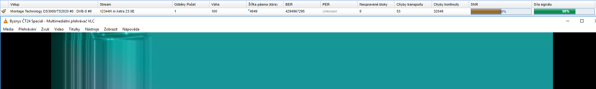

Hi all, I have problem with Terratec Cinergy S2 USB rev.4 (0ccd:0105 TerraTec Electronic GmbH Cinergy S2 Box).
I use latest libreelec, and CrazyCat drivers.

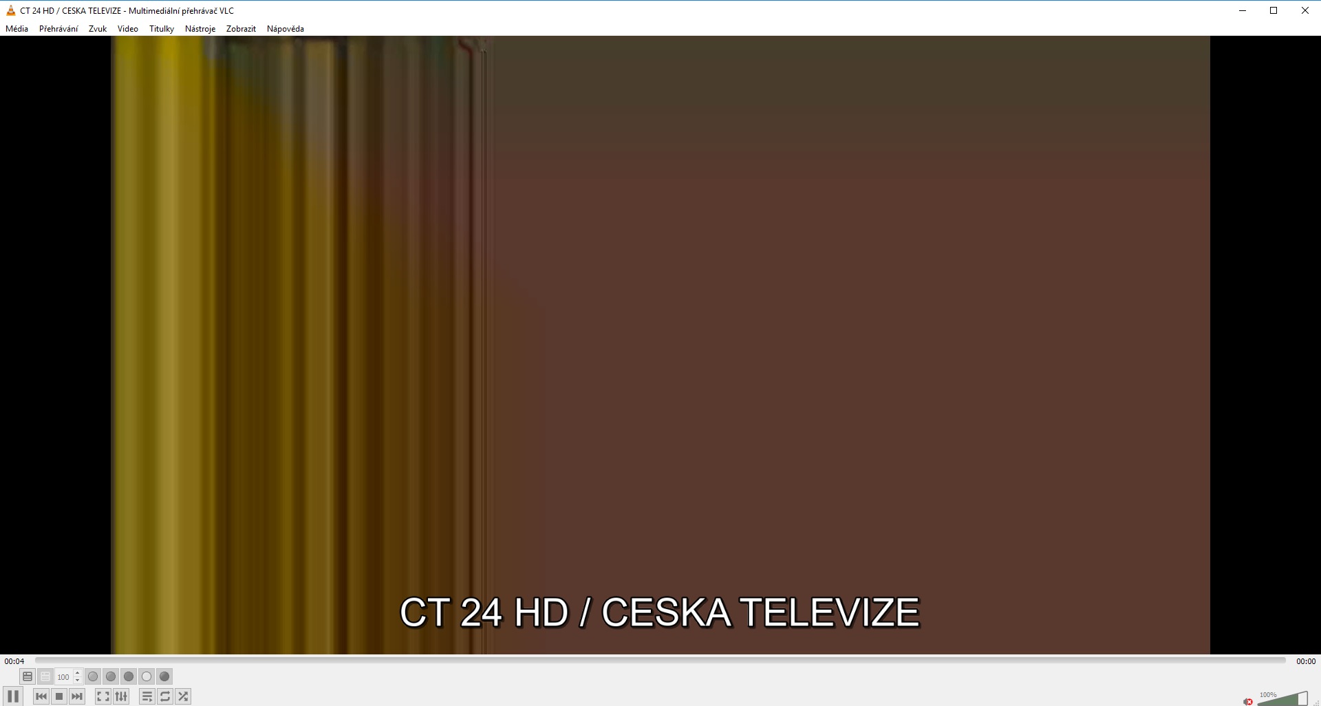

Tuner is working, and some transponders also, but lots of transponders not.
Channels is pefectly scanned, but is unviewable (I have lots of errors and bad signal), but my dish is correctly aligned, and worked on Windows.
Can you help me?
I suppose it is same problem that is described here: Geniatech Mygica HDStar DVB-S2 USB HD not working
Display More2019-09-09 06:52:16.595 [ INFO]:http: xxx.xxx.xxx.xxx: using ticket 05626A1267DEA9BE1E4BF7BC12160604F1979413 for /stream/service/44b566a220ac52c37d2ceffc22f6e158 2019-09-09 06:52:16.596 [ INFO]:mpegts: 12344H in Astra 23,5 - tuning on Montage Technology DS3000/TS2020 #0 : DVB-S #0 2019-09-09 06:52:16.913 [ INFO]:subscription: 0018: "HTTP" subscribing to service "Astra 23,5/12344H/CT 24 HD", we ight: 100, adapter: "Montage Technology DS3000/TS2020 #0 : DVB-S #0", network: "Astra 23,5", mux: "12344H", provider: "CESKA TELEVIZE", profile="pass", hostname="xxx.xxx.xxx.xxx", client="VLC/3.0.4 LibVLC/3.0.4" 2019-09-09 06:52:17.603 [WARNING]:tbl-eit: eit: 12344H in Astra 23,5: invalid checksum (len 936, errors 1) 2019-09-09 06:52:17.604 [WARNING]:tbl-pass: pass-eit: -: invalid checksum (len 936, errors 1) 2019-09-09 06:52:17.635 [WARNING]:TS: Astra 23,5/12344H/CT 24 HD: H264 @ #1310 Continuity counter error (total 1) 2019-09-09 06:52:17.635 [WARNING]:TS: Astra 23,5/12344H/CT 24 HD: MPEG2AUDIO @ #1320 Continuity counter error (total 1) 2019-09-09 06:52:17.635 [WARNING]:TS: Astra 23,5/12344H/CT 24 HD: DVBSUB @ #1350 Continuity counter error (total 1) 2019-09-09 06:52:17.635 [WARNING]:TS: Astra 23,5/12344H/CT 24 HD: TELETEXT @ #1130 Continuity counter error (total 1) 2019-09-09 06:52:17.773 [WARNING]:TS: Astra 23,5/12344H/CT 24 HD: MPEG2AUDIO @ #1323 Continuity counter error (total 1) 2019-09-09 06:52:20.615 [WARNING]:TS: Astra 23,5/12344H/CT 24 HD Transport error indicator (total 1) 2019-09-09 06:52:27.644 [WARNING]:TS: Astra 23,5/12344H/CT 24 HD: H264 @ #1310 Continuity counter error (total 2615) 2019-09-09 06:52:27.644 [WARNING]:TS: Astra 23,5/12344H/CT 24 HD: MPEG2AUDIO @ #1320 Continuity counter error (total 357) 2019-09-09 06:52:27.672 [WARNING]:TS: Astra 23,5/12344H/CT 24 HD: TELETEXT @ #1130 Continuity counter error (total 278) 2019-09-09 06:52:27.786 [WARNING]:TS: Astra 23,5/12344H/CT 24 HD: MPEG2AUDIO @ #1323 Continuity counter error (total 65) 2019-09-09 06:52:28.013 [WARNING]:TS: Astra 23,5/12344H/CT 24 HD: DVBSUB @ #1350 Continuity counter error (total 35) 2019-09-09 06:52:28.519 [WARNING]:tbl-eit: eit: 12344H in Astra 23,5: invalid checksum (len 276, errors 11) 2019-09-09 06:52:28.519 [WARNING]:tbl-pass: pass-eit: -: invalid checksum (len 276, errors 11) 2019-09-09 06:52:29.275 [ INFO]:subscription: 0018: "HTTP" unsubscribing, hostname="xxx.xxx.xxx.xxx", client="VLC/3.0.4 LibVLC/3.0.4"Thanks.
