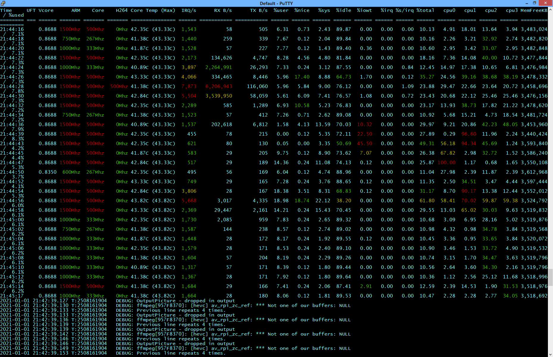

24.000 720p h.264 (rendered at 1080p 24Hz; also see 3:2 below) - stutters
23.976 480p mpeg4 (rendered at 1080p 23.98Hz) - stutters
23.976 1080p h.264 - stutters
23.976 1080p h.265 - stutters
24.000 1080p h.264 - stutters
24.000 2160p h.264 - stutters
25.000 480p mpeg4 (rendered at 1080p 25Hz) - stutters
25.000 2160p h.265 - stutters
29.917(?) 2160p h.264 - stutters (LG Greece & Norway demo)
29.970 2160p mpeg4 - stutters
59.940 2160p h.265 (rendered at 1080p 59Hz) - stutters
I also enabled 3:2  pulldown for the following:
24.000 720p h.264, disp at 720p 60Hz - stutters
YouTube:
29.970 360p h.264  (rendered at 1080p 29Hz) - stutters
23.976 720p h.264  (rendered at 720p 59Hz) - stutters
29.970 720p h.264  (rendered at 720p 59Hz) - stutters
24.000 1440p vp9 (rendered 1080p 24.00Hz) - stutters
24.000 1440p vp9 (rendered 2160p 24.00Hz) - stutters
23.976 2160p vp9  - stutters
59.940 2160p vp9  (rendered at 1080p 59Hz) - stutters
In  other words, I can't  find ANY video file or YT stream that  doesn't have stuttering audio.
Note that with BT audio out, there's no stuttering on any of these.
And MP3 files play fine on analog out.
And everything worked in LE 10.
Thanks again!
