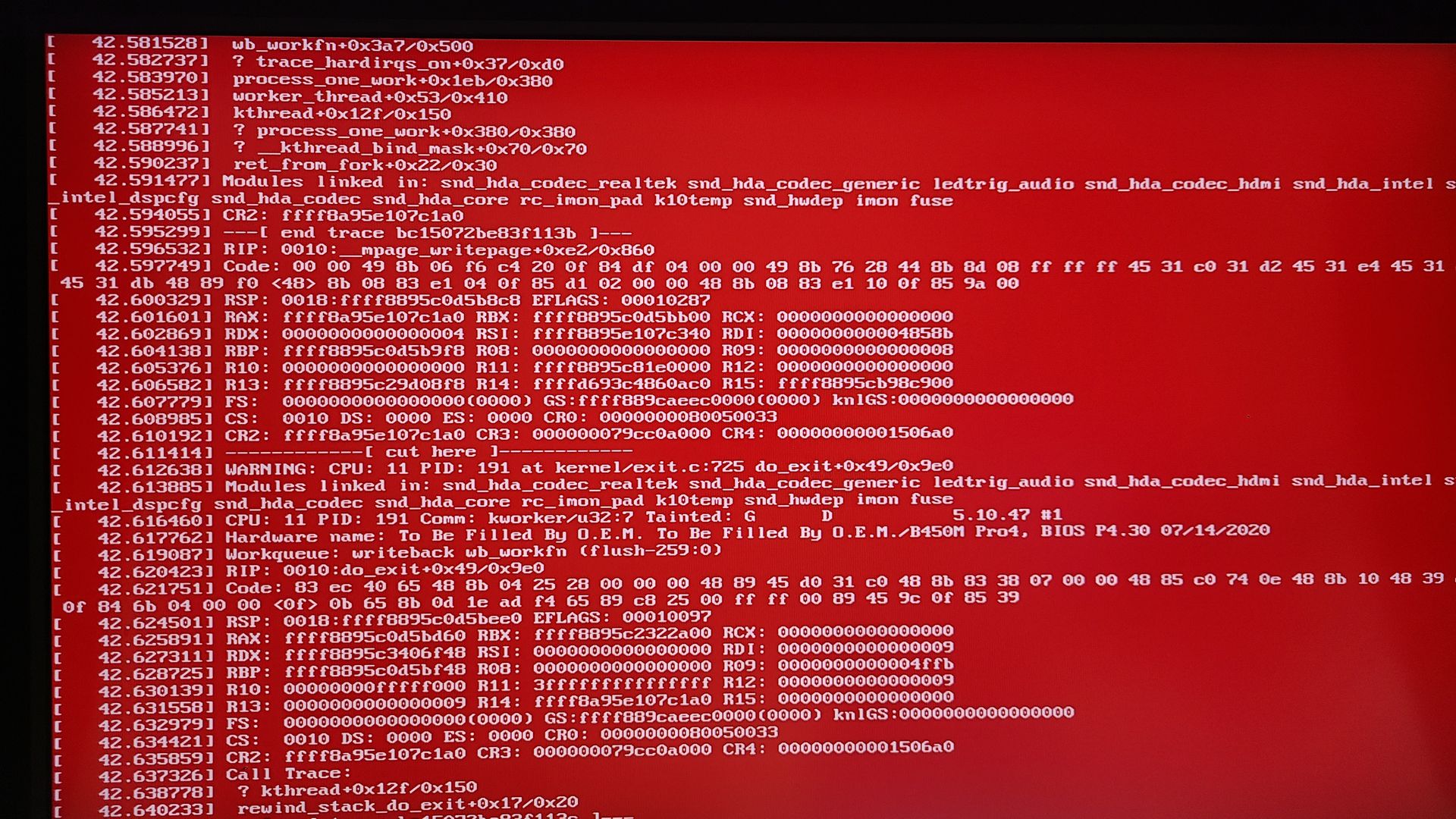

Hi All,
Hope I did this correct if you need me to do it again tell me..

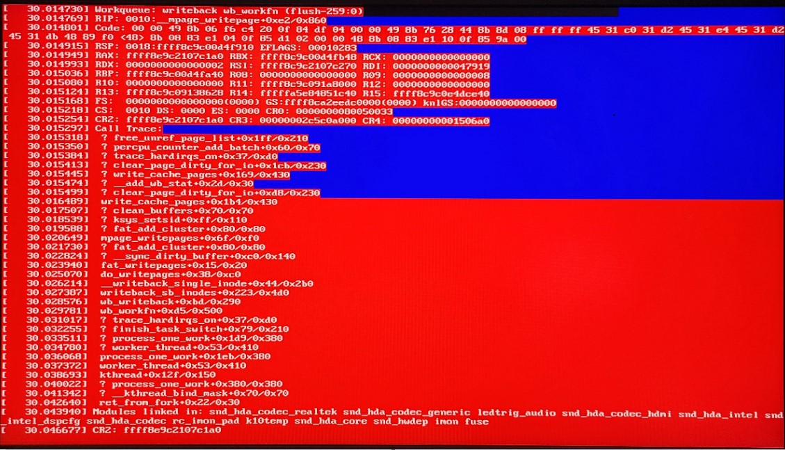

So I tried to do the install, it failed,
I then ran the install did the Alt-F3 and followed the above
paste bin URL is: MJASRock450 - Pastebin.com
on a side note I eve tried to run live and it barffed up LOL
If this paste bin is wrong or grabed at the wrong time tell me and I will try again
Thanks U all rock!!!!

Hi and again thanks for the qucik response.
I even tried originally to do an upgrade and it get the same issue...
Tried diferent stick, 3x different ports no success.
Bios is at most current for recommended Processor type.
Tried the nightly LibreELEC-Generic.x86_64-11.0-nightly-20210923-7455a76.img and get the exact same error gets to like 65% on the install
its strange as i can install the LibreELEC-Generic.x86_64-9.2.6.img.gz with out a hitch ![]()
Love the product been using it since 2013 keep up the great work, this is a brand new box build all new hardware so it perplexing why the 9.2 installs fine and this does not

Hi All so I tried this back a while ago when it was RC and though maybe it would be fixed by now.
When starting a new install from USB with a freshly DL Image LibreELEC-Generic.x86_64-10.0.0.img.gz
I get a redscreen you see below:
My Machine is running B450M Pro4 P4.30 board with AMD Ryzen 5 2600 six core processor, 32 GB of DDR-2133 ram (2x16GB sticks)
and a Gigabyte GeForce GTX 1050 Ti OC Low Profile 4GB GDDR5 128 bit PCI-E graphics card
Prior version of OS ran perfectly no issues
Hope some one can help
