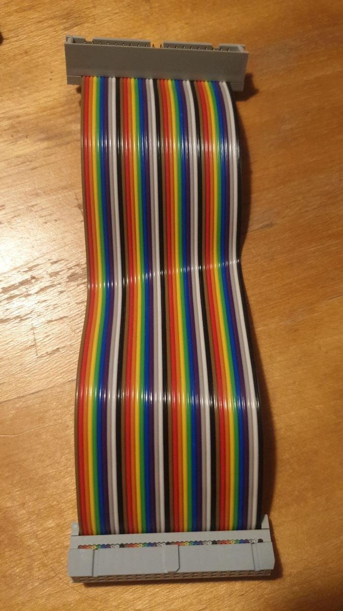

    Because of the cooling chassis I wanted to use an GPIO extension cable (see image).
    That caused the DAC to fail. It does work without the cable sitting on a GPIO stack expander (not ideal).
    Is this a known issue with RPis GPIO and extension cables?
