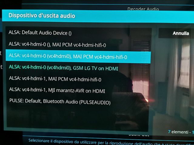

    To me, on the other hand, I still can't get the audio to work, if I connect my Marantz av7701 to the second hdmi output of the raspberry pi4.
    The receiver is regularly recognized and with the method written in this thread, the receiver also works and I turn it off when I turn on the raspberry, but unfortunately no audio.

    I am also doing some tests with my hdmi 1.4 receiver like yours and a LG oled 65c8, but until now I have not been able to get the audio from the receiver to work, in your tests the audio from the receiver you have managed to make it work.
    Today I made a last attempt, replace the hdmi cable that goes from the raspberry to the receiver, even in this case it doesn't work.

    I connected the raspberry to an hdmi port on the receiver which I am sure it works and my receiver manages all the encodings up to True HD and DTS Ex. But even when the passthrough is turned off, no sound is heard, not even the sounds of the skin.
    Today I tried the following build on my raspberry:
    LibreELEC-RPi4.arm-10.0-nightly-20210306-f4e99c3.img
    I connected the rasbperry's hdmi 0 output to my tv, hdmi 1 output to my old receiver which is not a 4k, so hdmi 1.4.
    HDR works perfectly, but despite that in the audio setup menu, the hdmi audio output of the receiver, no sound is heard.
