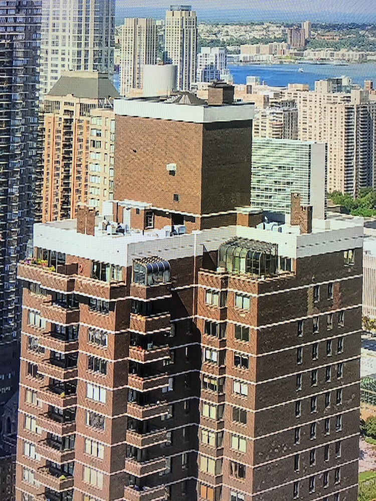

Now that i got a 4k TV, I tried it out by playing the following 4k demo LG: New York HDR UHD 4K Demo | 4K Media.
I noticed in the 2nd scene, especially the tall brown building in the front, aliasing on the borders of the windows.
When I play the exact same file with VLC on Windows 10 it is much smoother without any staircase effect.
Now I thought maybe my settings are somehow messed up, because of alle the update migrations,
but also on a untouched 8.90.015 there is the same effect.
I added two pictures, one taken from the "untouched" LE 8.90.015 and one from VLC with my phone.
The TV and Kodi Interface is @ 4k resolution, also the TV shows 3840x2160 on the information panel.
Is 4k simply not possible at the moment?
But on the other side there are some people here who say its working for them.
Any ideas?

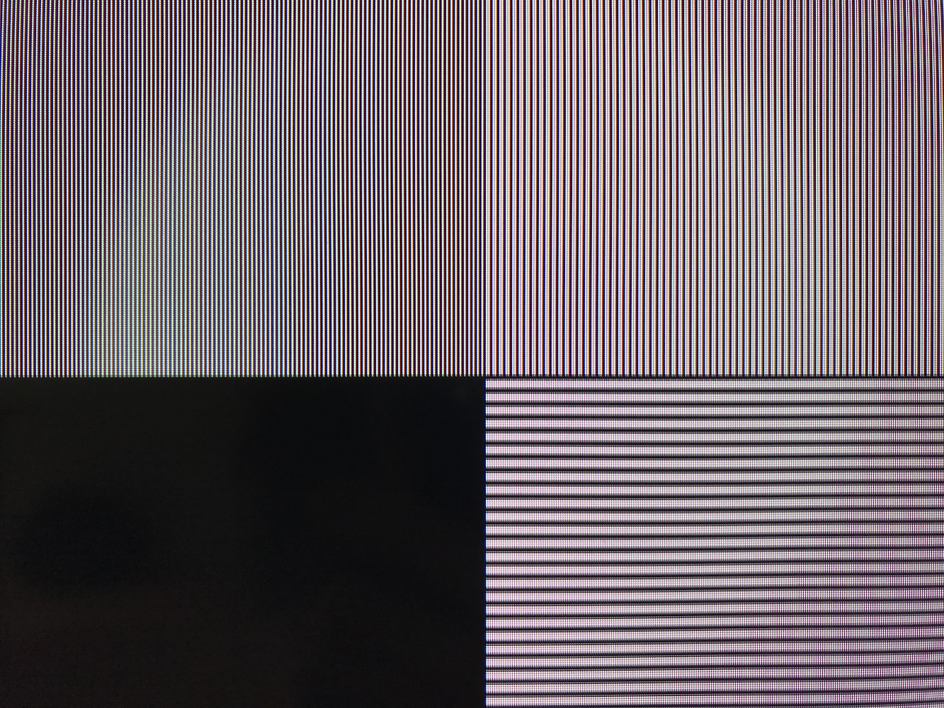

Edit: Okay, just did another test with both my everyday LE and the untouched:
I made a short 4k clip of this test picture and played it on both.
The upper section looks as it should (except light green hue) -> the lines on the upper left section are 1 pixel apart, but it seems like the horizontal decoding is wrong.
(very close up capture)
Because both show the same result, I think my settings do not affect this and it might be a general decoding error...
