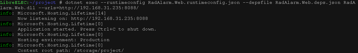

    Hi all!
    SYSTEM:
    Libreelec nightly-20220401-aa8df56 (H6.arm)
    ASP,NET Runtime 6.0.1 addon
    Trying to run a service with ASP.NET Core + Angular + MariaDB application. If I run it in the terminal via Putty, everything works fine. The site opens outside the network.
    I.e. the application works fine.
    dotnet exec --runtimeconfig RadAlarm.Web.runtimeconfig.json --depsfile RadAlarm.Web.deps.json RadA
    larm.Web.dll --urls=http://192.168.31.235:8088/
    But when I close the terminal and closes the application session so I need to install the application as a service.
    Found a sample service configuration in documentation and finalized it:
    the service will not start with this configuration
    The following error is written in the logs:
    Have any idea how to fix this ?
    Thx before for any help!
    Ugh...
    сlose this thread
    Problem solved
    added a line
    Environment=DOTNET_SYSTEM_GLOBALIZATION_INVARIANT=1
    Hope this help somebody too )
