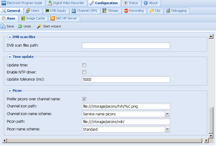

    Ok, I made a small script to create a new set of channel name based icon files (snp) and I can reproduce same exact issue, FYI they also use imagecache/nnn urls (despite image cache is disabled and path is set as 'file:///storage/picons/tvh/%C.png') and the delays/timeouts when kodi on RPi is fetching them are exactly same as for picons (srp).
    Btw I'm curious why I can't see anything on tvheadend log when it is serving icons even with debug enabled and subsystems set to +all... you have any idea? maybe trace debug would show something, but if I understand it needs to be enabled at tvheadend compile, right? If you have any idea I'm ready to do any tests you need.
    Nothing is logged at tvheadend when the problem happens, even with debug subsystems set to +all, anyway I did exactly as you asked, incl reset icons for all channels, then reproduced the problem (i.e. browsing the channels list) and I'm attaching both tvheadend and kodi logs and some screens.
    Btw, I notice on your screen that you use channel icons (channel name based) and not picons exactly... maybe the issue is only with picons? I notice that picons show as picon:// and channel icons show as file:/// in the user icon column in channels list, despite both set as file:///... paths as you can see on config screens, and yes I did reset them.

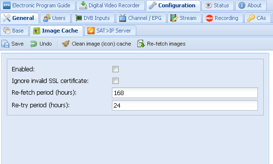

    1. I have "Image Cache" option disabled in tvheadend options (never enabled it in fact), however aparently imagecache is used anyway for local picons (i.e. when "Picons path" set to file://...), if you enable kodi debug you should see what I mean (i.e. requests to /imagecache/nnn urls as in my log).

    My picons are very similar to the ones you pointed on srp files, transparent png's, 220x132, same file names format... and yes I did put them at /storage/picons/vdr/ for tvh42 as it is set on it as default path...
    However after you mention imagecache problems I did a few tests more and instead of setting "Picons path" to file://... for local picons I did instead set it to an http:// url pointing to an apache server I have running at another pc at my LAN, and hosted picons on it for sure... the result is that now kodi at RPi fetches them very fast from the apache server! (as it should, and similar to what kodi on Windows always did)
