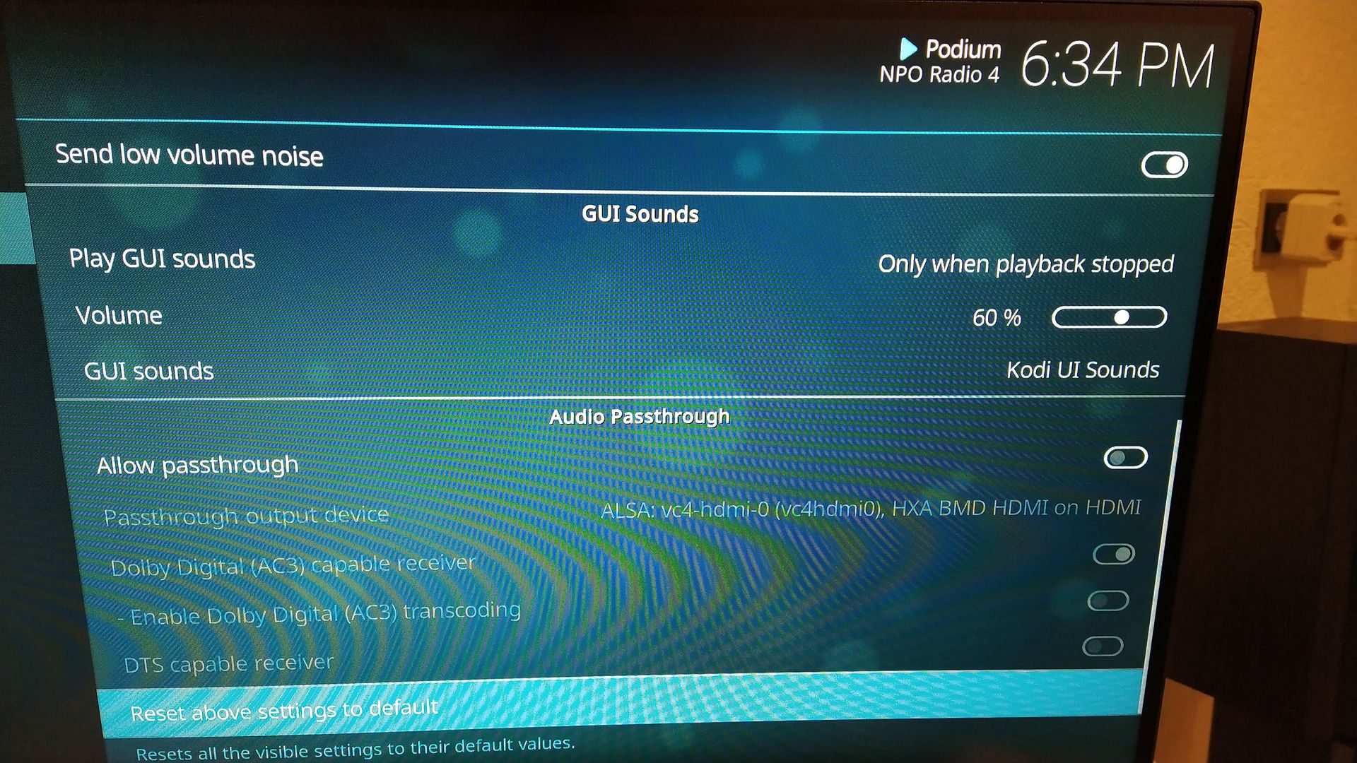

    After the video issue was solved I had troubles with Radio channels. There was no sound. Sometimes it worked, but most of the times it didn't work. After I deactivated "RDS information" the radio-channels were OK. I don't understand why?
