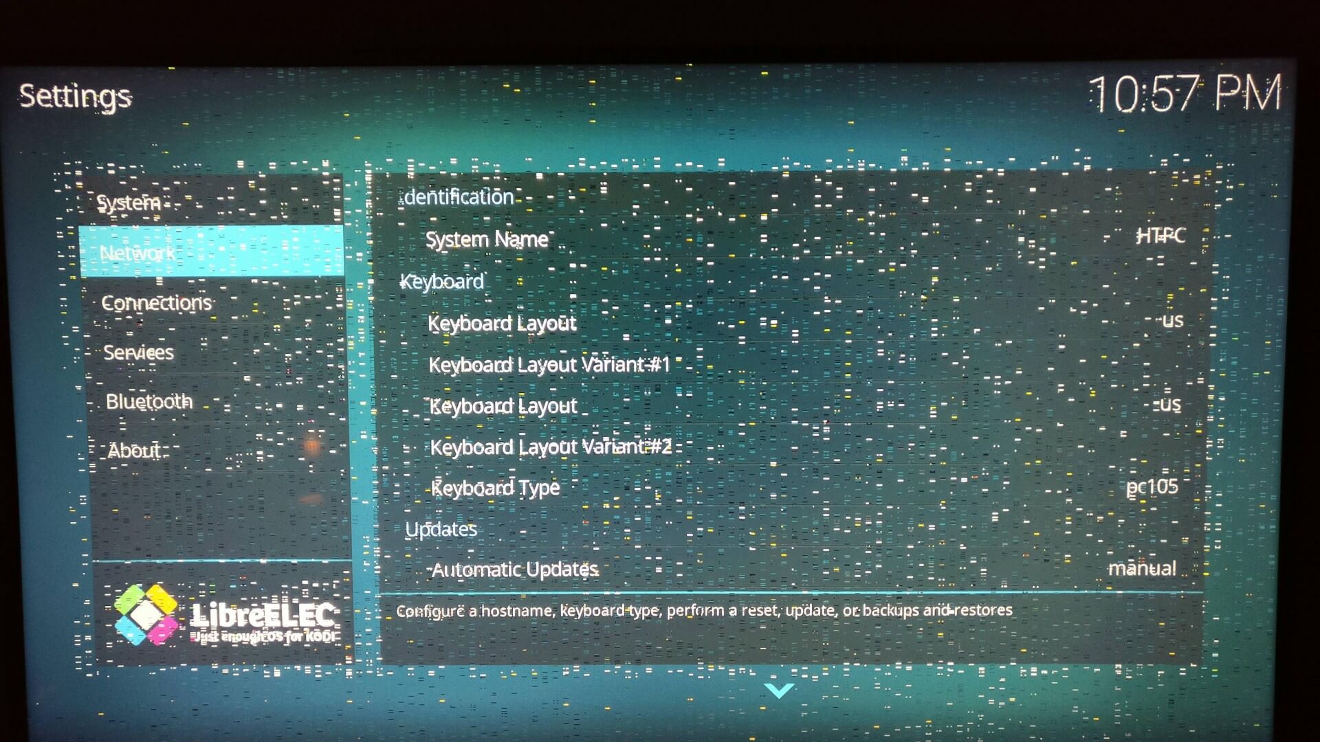

    I have a good-working system built on an i3-2100T (2nd gen - sandy bridge) running 7.0.3.
    I have tried upgrading to 7.95.x, 8.0, and 8.02. All of them seem to boot up fine *once* after the upgrade, but then will lock up and boot into blank screens after the libreelec logo. Sometimes i am able to get past the splash screen and the screen is all visually garbled up as shown in the attachment. It works for a few seconds then locks up. 8.02 boots into a blank screen every time. This causes a bit of a nightmare as the box isn't available via ssh when it locks up, which prevents me from restoring the backup, so I have to backtrack to 7.0.3 and restore from there.

    For others reading this thread, here is what I did:
    - used the backup addon in OE to create a full backup, including addon data (you have to enable it in the addon config)
    - transferred the backup folder to a network share
    - loaded the generic full image of LE onto a USB
    - boot htpc from the usb
    - attempted an upgrade. The installer errored, not enough room on the disk (this means my OE system partition got too full over the years and there isn't enough room for the upgrade)
    - decided to just do a clean install, accepting all the "this will wipe everything" warnings.
    - Booted up into LE and downloaded the "backup" addon from the kodi repository
    - Restored the backup
    This took awhile, but seems to have worked. Everything came back (including the audo addon) and works well. Everything feels much, much faster.
    I'm sure there was an easier way but just sharing what I did and confirming it worked!
