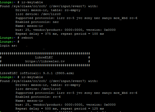

    Hope someone of this great Comunity can help me for my Problem.
    I`ve installed LE 9.0.1 to the micro SD Card on my Probox2 AIR.
    LE is running and the original "AirMouse" Remote control (2,4 Ghz) works fine out of the Box.
    But my second IR Remote ( similar to the one like Lordjontan in post #47) does not work.
    Lordjontan : I put your files (m8s and rc_maps.cfg) in the specific folders and executed ir-keytable -a /storage/.config/rc_maps.cfg -s rc0 and ir-ctl -t 50000  and ir-keytable -D 375 -P 100
    After that the Remote Protocol is changed from rc-6 to nec and everything works fine.:)
    But after a reboot of the box i have to execute this three commands again to change the Protocol back to NEC and the delay time etc...
    Hoy can I permanently "set" the Protocol from "rc-6" to "nec"??
    Thank you....
