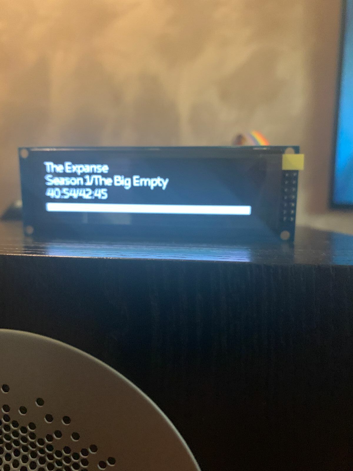

I did change the font with arial bold, it is better now.

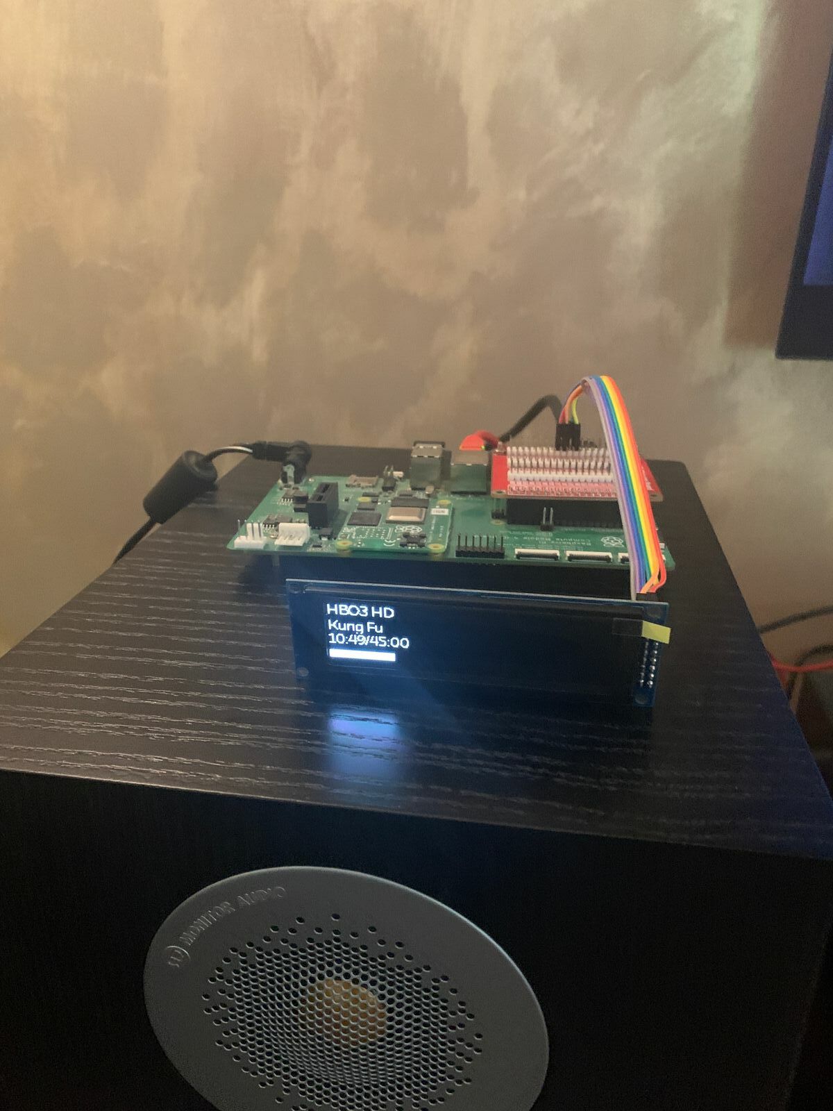

Another picture with progress bar which follows the player.
