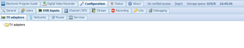

    what i see is it's trying to use the same driver (dvb_usb_dib0700) that was working on LE 8.2.5 but on 8.95 no way, tvh shows no connector available:

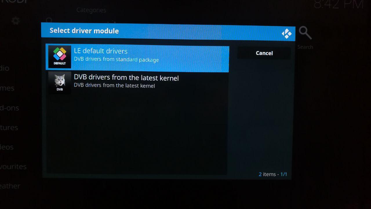

    by the way I had more time to investigate today and:
    • changing dtb.img
    • switching to "DVB drivers from the latest kernel" in libreelec driver addon
    i can see crazycat mentioned in dmesg | paste log.
    maybe the message "no frontend was attached by 'Microsoft Xbox One Digital TV Tuner'" could lead to the issue?

    the dongle seems recognized in one case not in the other one, but not very clear to me :blush: :
    by the way usb port and the overall configuration is exaclty the same, in both cases loading LE via SD, the only difference is LE image.
    thanks again for your time

    All our releases (besides Wetek Core and Play1) have still the crazy cat drivers shipped. Pls have a look at the announcement at libreelec.tv there it is described how it works. You need to activate it at the driver chooser addon.
    thanks for your reply. i already checked the information at post #1 and also watch the video but the only options i see in the "LibreELEC Module Drivers" AddOn are the following:

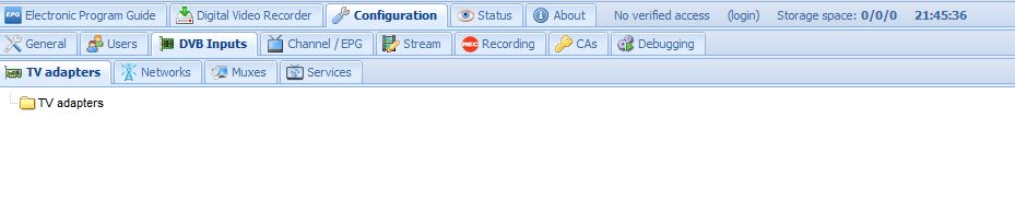

    and i tried both of them but still after rebooting no adapters:
    wile with 8.2.5 image they were shown.
    that's why i was wondering if in the image "LibreELEC-S905.arm-8.95.002.img.gz" those drivers were not included or if i was missing something. Anyway just to double check, is this the procedure to "activate" the drivers you were referring to, right? can i check something else?
