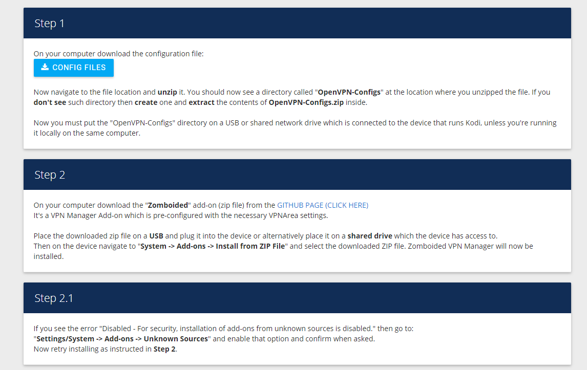

Sorry this was indeed Kodi 16 log... I downloaded every LibreELEC version to try and better understand my problem hence also 16.. Problems started with up to date Kodi version few days ago (all was great for over year)... I will upload Kodi 17 bit later.. tbh not sure why I had old version of your addon on this attempt. Perhaps VPNArea guide link is old. btw reason I'm using custom .ovpn files, this is actually official guide from VPNArea.. Your build in support doesn't include all servers if I remember correctly.. also maybe that's why no one reported it (if they follow official guide from VPNArea?)
