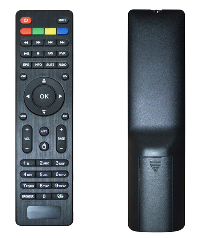

Display MoreAnd what is the driver for the default remote control (K1 plus S905 see picture below) to connect to as a second remote control?
One more problem - how to map letters from remote control with keyboard in Lircmap.xml file?
In the file in the rc_keymaps directory I have eg
"0x72ddb0 KEY_Q"
and try to assign it to lirc in Lircmap.xml in various ways
<q>KEY_Q</ q>
<letter_q> .... unfortunately nothing works
How can I map a letters and special characters, e.g., space, comma, dot, at, slash, backslah, colon, etc.?
