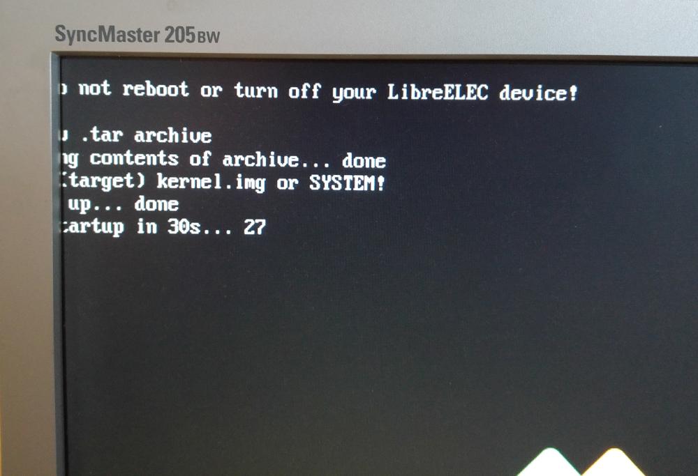

First I just copied it into /storage/.update without changing anything else. Which again brought the "Missing (target) kernel.img or SYSTEM!" error as before:
But I found out that after mounting the /flash partition the init script tries to execute /flash/post-flash.sh if it exists.
So I created a script with that name and the following content:
The next update attempt then worked!

Two day ago I tried to upgrade to the latest alpha (8.90.008) and realized that this also did not work. I then connected a LCD and saw that the upgrade script (packages/sysutils/busybox/scripts/init I assume) failed with "Missing (target) kernel.img or SYSTEM!". That made sense, because there was no kernel.img in /flash. There was just a /flash/KERNEL (and as far as I can remember has always been). I then created an empty /flash/kernel.img file and the upgrade finally succeed (but the upgrader copied the new kernel into /flash/kernel.img).
I looked into projects/WeTek_Play/options and saw that KERNEL_NAME="kernel.img" is set there. Is this a mistake?
