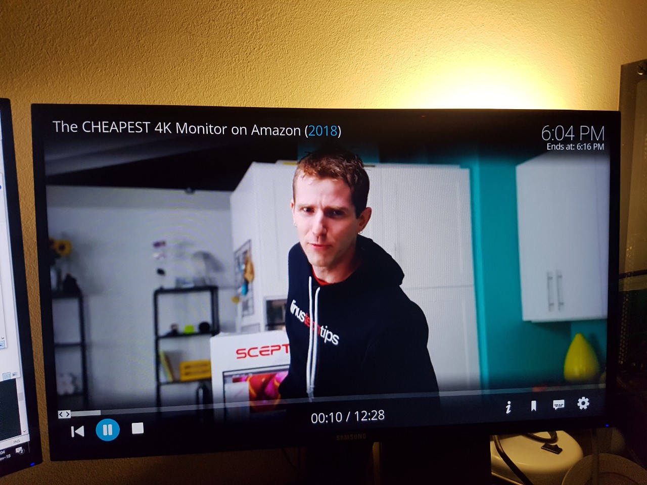

HiassofT , I've installed it, the WiFi is working out of the box once again. And it works well. I've tried Youtube plugin, Twitch plugin, it's stable and the stream at 1080p is fluid.

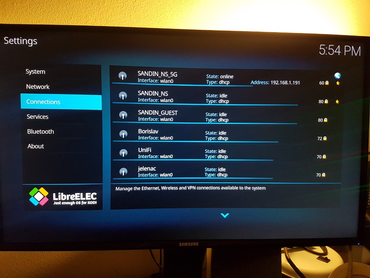

Even after reboot, wifi still works, and auto-connects to my 5GHz network. It works really well. No connection drops.
However there were few issues I've noticed. I don't know if this is related to the drivers I copy-pasted or the system itself: When I connect to the 2.4GHz network, and then try to switch to 5GHz network, I get a black screen and KODI resets itself (not the entire box, only KODI as an app), I get only KODI 18.0 LEIA boot screen, not the LibreELEC boot screen. Also, if I delete all currently connected networks, and I keep switching between Connections and Network setting multiple times, really quickly, I get KODI app to crash again. But if I don't fiddle with connections, the connection is stable and doesn't drop. I can watch youtube streams and twitch streams without any issues and no connection dropouts.
