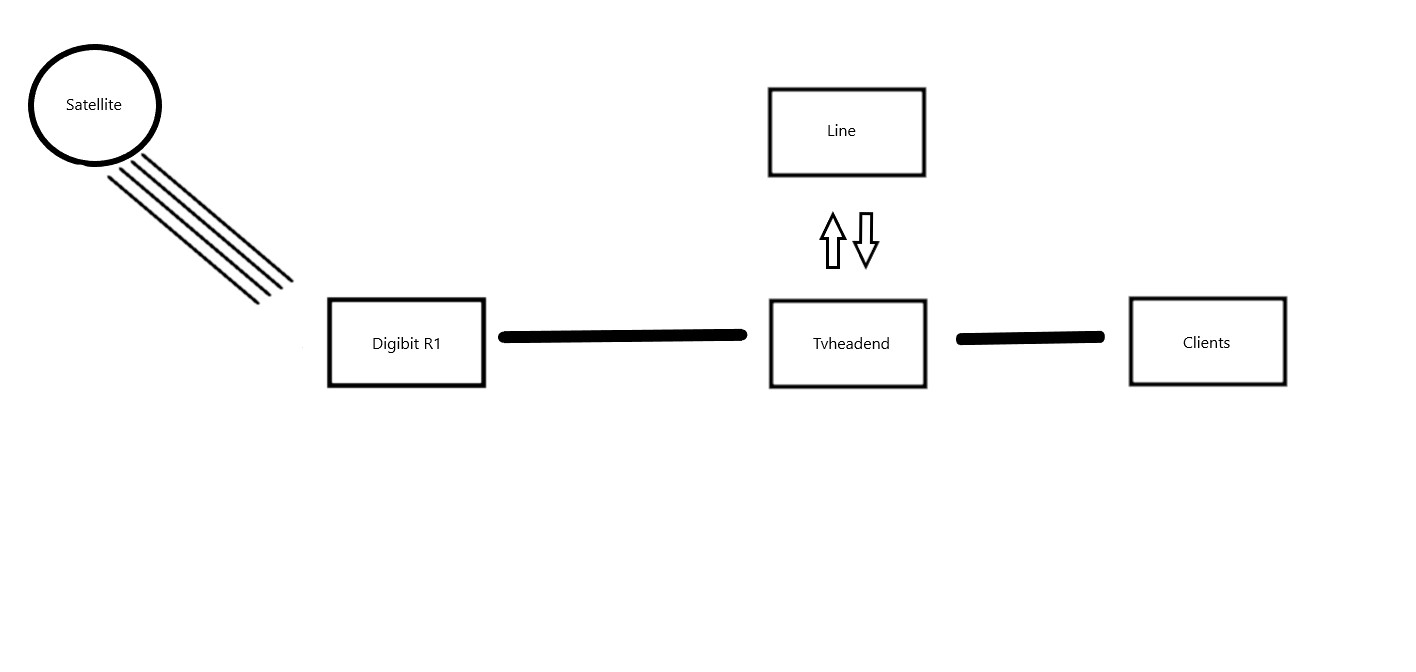

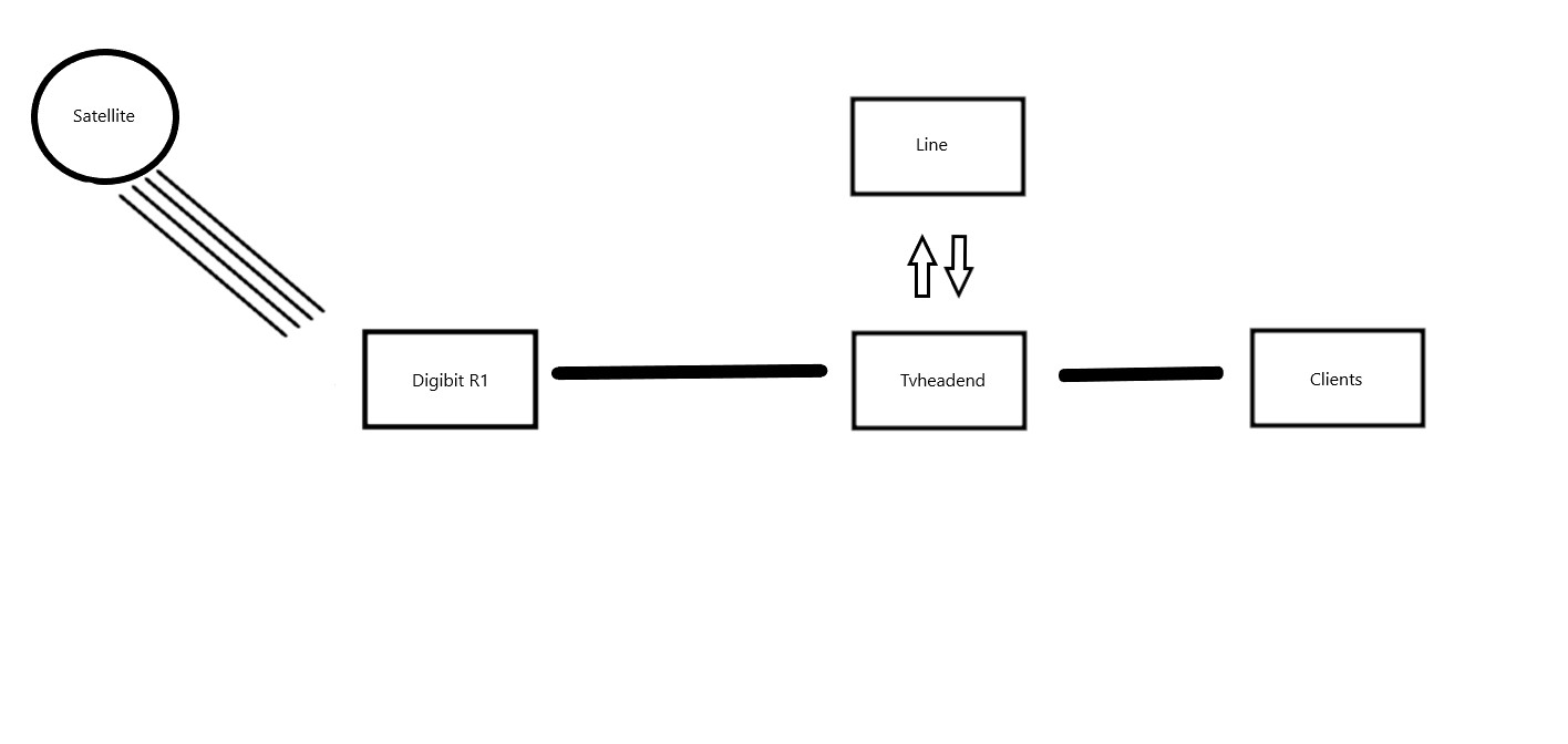

Probably not. The channels are scrambled and the directv box descramble them.
To use R1 you would need a service to decode the channels (lines or cards) and would not need the directv box.
