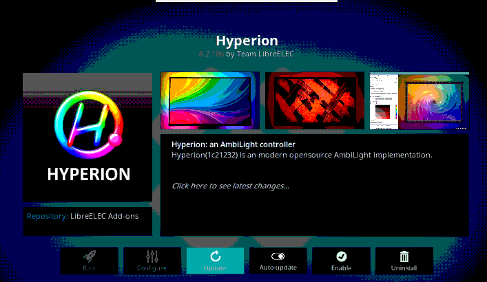

    LibreELEC:~ # /storage/.kodi/addons/service.hyperion/bin/hyperiond.start
    LibreELEC:~ # Hyperion Ambilight Deamon (639)
    Version : 1c21232
    Build Time: Oct 12 2017 09:47:51
    INFO: Selected configuration file: /storage/.kodi/userdata/addon_data/service.hy perion/hyperion.config.json
    HYPERION INFO: ColorTransform 'default' => [0; 45]
    HYPERION INFO: ColorCorrection 'default' => [0; 45]
    HYPERION INFO: ColorAdjustment 'default' => [0; 45]
    LEDDEVICE INFO: configuration:
    "colorOrder" : "rgb",
    "name" : "MyHyperionConfig",
    "output" : "/dev/null",
    "rate" : 1000000,
    "type" : "file"
    INFO: Creating linear smoothing
    HYPERION (CS) INFO: Created linear-smoothing(interval_ms=50;settlingTime_ms=200; updateDelay=0
    EFFECTENGINE INFO: 27 effects loaded from directory /storage/.kodi/addons/servic e.hyperion/effects
    EFFECTENGINE INFO: Initializing Python interpreter
    INFO: Hyperion started and initialised
    INFO: Boot sequence 'Rainbow swirl fast' EFFECTENGINE INFO: run effect Rainbow s wirl fast on channel 0
    BLACKBORDER INFO: threshold set to 0 (0)
    BLACKBORDER INFO: mode:default
    started
    terminate called after throwing an instance of 'std::runtime_error'
    what(): JSONSERVER ERROR: could not bind to port
    LibreELEC:~ #

    Hmm I get this, do I miss some params?
    LibreELEC:~ # /storage/hyperion/bin/hyperiond.sh
    Hyperion Ambilight Deamon (643)
    Version : V1.03.4 (brindosch-c750c41/dc6a602-1522918225
    Build Time: Apr 5 2018 01:57:25
    ERROR: Missing required configuration file. Usage:
    hyperiond <options ...> [config.file ...]
    LibreELEC:~ #
    Hm I get this
    LibreELEC:~ # find / -name "hyperion*" -print
    /storage/hyperion
    /storage/hyperion/config/hyperion.config.json.example
    /storage/hyperion/bin/hyperion-v4l2
    /storage/hyperion/bin/hyperion-dispmanx
    /storage/hyperion/bin/hyperion-remote.sh
    /storage/hyperion/bin/hyperion-v4l2.sh
    /storage/logfiles/hyperion.log
    /storage/.kodi/addons/plugin.program.hyperion.configurator/hyperion.config.json.temp
    /storage/.kodi/addons/service.hyperion/config/hyperion.config.json.sample
    /storage/.kodi/addons/service.hyperion/bin/hyperion-v4l2
    /storage/.kodi/addons/service.hyperion/bin/hyperion-dispmanx
    /storage/.kodi/addons/service.hyperion/bin/hyperion-remote
    /storage/.kodi/userdata/addon_data/service.hyperion/hyperion.config.json
    /storage/.config/hyperion.config.json
    LibreELEC:~ #
