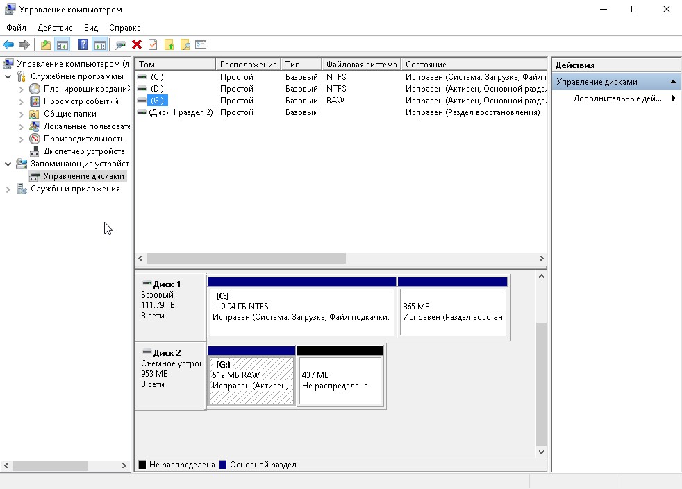

I extracted 2 files from the * .tar.gz archive. Launched Win32 Disk Imager. Opened the bootloader.img file. I pressed the button to write. After that, the SD on the computer is not readable, but you can see 2 partitions.
Apparently the update went wrong and you deleted the bootloader. If you have a UART to USB converter then we can try to revive your box and install LE.
