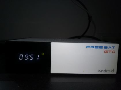

@ The Coolest (aka DisplayMAN)
I want say a very very big thanks for your support and hard work on add support to GTC Display Driver.
For who is interest i have open a dedicated thread for GTC users but here users can dowload The Coolest drivers.

Hi to all ppl,
i want share my little experience with this box and open this thread for all other GTC users that want replace stock buggy firmware with stable libreelec.
The GTC is a dual tuner dvb-s2/t2/c box with s905d
It have an Android 6 and at the moment with the original firmware very bugs.
Developers not respond and no support the GTC users.
This box have good hardware specs s905D, ram 2gb, rom 16gb.
It have an gxl_p231_2g board, dvb drivers will be cxd28xx ( DDbridge ??)
for who is interest i have attached dtb decompiled.
At the moment i have MicroSD install:
LibreELEC-S905.arm-8.2.5-Chroma.422.10bit.img
This version work ok for me, big thanks to libreelec developers, so i have create the remote.conf file attached ( put it into /storage/.config and rename to vfd.conf and after restart the box remote work).
So i want say a very BIG THANK to libreelec developer The Coolest. He add support
for GTC display driver working on Libreelec 8.2.5, the drivers can be installed with an easy shell command
Quotesh install.sh
drivers can downloaded from here
Quote
Internal tuners are not supported but can replace them with an external usb one. I try different usb dvb dongle and they works ok.
For any question about GTC and librelec please use this thread.
