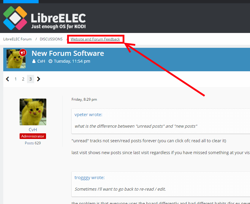

Also going one level up (from thread to forum) is +1 click more for me.
it is actually just one click ?!
only 1 sometimes 2 posts on my tablet screen that I see
this gets fixed - the smallest view isn't trimmed at all and waste a lot space (the default theme waste space everywhere)
