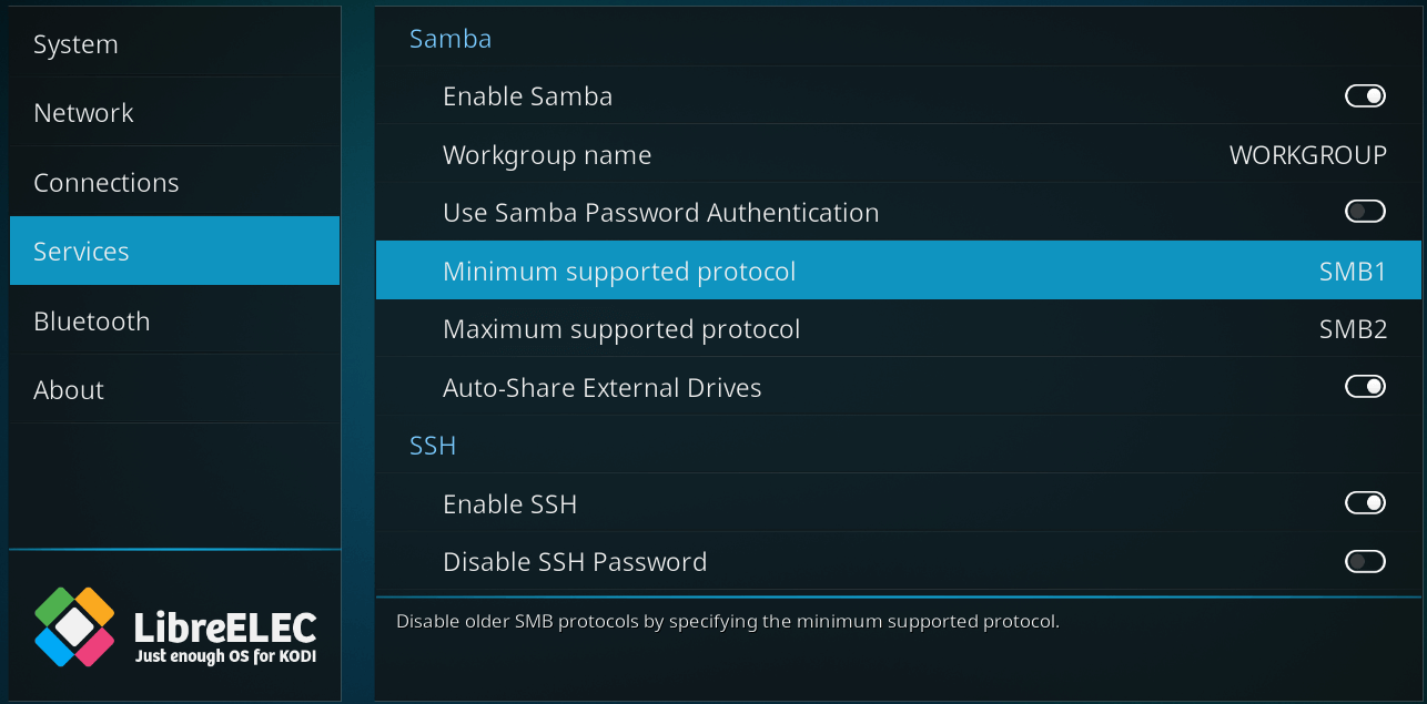

Options=username=nasuser1,password=123nas,rw,vers=1.0
could you try that ^^^ ? vers=1.0 is forcing the connection to the old connection - if that works your NAS is definitely out of date or misconfigured ![]()

BUt why does it work in LE 8.0
We don't support anymore the old broken Samba (Windows Shares) versions anymore that worked without username/passwords like also Windows is doing it these days.
No device after Windows XP should use this these days. If your NAS ... doesn't support anything that is standard since 10 years you can set the samba version to the ancient 1 (like said heavily broken and rather slow) at LE and it should work again (better fix your NAS instead).

I have no username or password
okay, then you likely use SMB1 aka Windows XP share (heavily outdated, bugged and highly insecure against viruses etc ...)
does it work without ?
