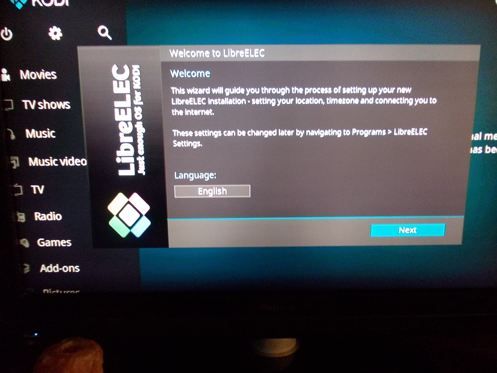

    Hi all
    After some tryouts I get this one to work with multitool, LibreELEC-RK322x.arm-10.0-nightly-20230925-65bd849-rk322x
    and installed it intern and it boots, the most did not, one image did brick the box. Using the magic clock short did renew it.
    but it is not that stable, no wifi (I have a sv6256p chip) but remote works.
    The kodi itself do not go higher then 1260 x 720, it plays hevc without issues but
    I need to set the resolution higher then 1260, and when i do set up subtitles it does not fremember I have to set these
    on over and over again. I have install this on a mxq pro 4k rt3229 sv6256p wifi, but believe this cpu is only 32 bit.
    Maybe some can advice me of a box who is best to use, with digital out, that is a must because I building a tube out dac.
    Is there alsoa image who is stable for this box? And how can I get into the box for updates like the drivers tdb etc.
    I am green behind the ears for linux I have to tell.
    regards

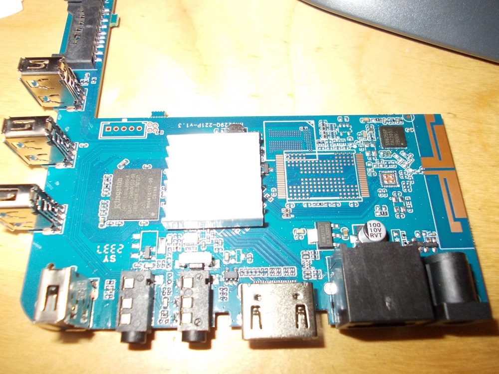

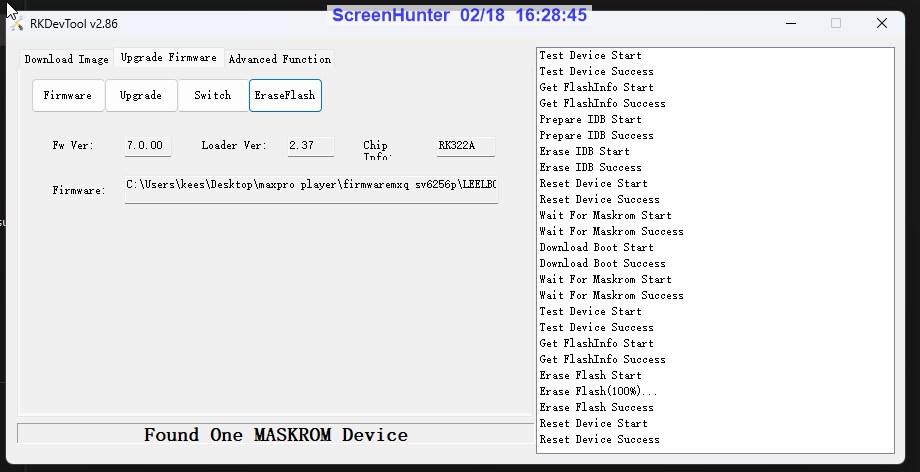

    Hi All
    I have now some test done, like to find the clock pin of a chip who clock is below the chip and not reachable, I found
    that the empty space for a normal memory chip did work, and have maskrom back.
    I have tryed different libreelec images, but when I put it internal with multitool, it does not boot, or even did brick the box,
    that is why i had to find the clock pin. On the arbian forum I had some help, but I need to be here because it is for a movie
    box with digital out who drive later the dac i am building with tube outputs.
    So have to test and learn.
    I have put a log on thread.
    The card is working on 64 gig can write to it, I think it is a mistamp, but have a new one
    who do give proper gig,s as printed on it.

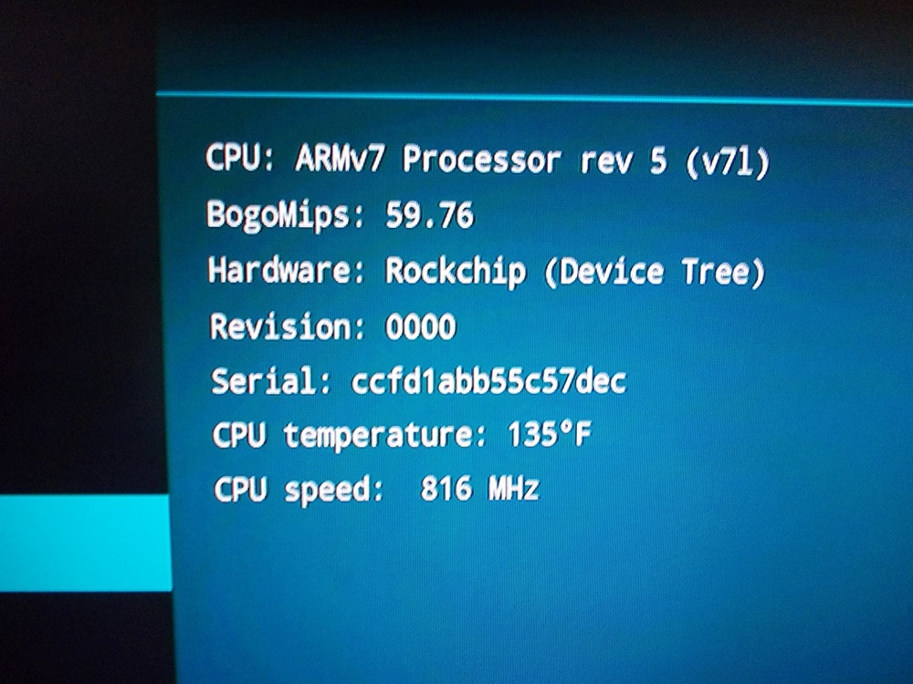

    Some update.
    I have installed libreelec LibreELEC-RK322X.arm-11.0-nightly-20240218-d7324fb-rk322x.img into the box, and it does
    start and work, but no wifi (sv5256p) and sound is very load overload the tv, I can set it lower with the mouse (works) but the remote does not work there, I have to say the original software the box came with did also not work on sound volume buttons.
    It has to better to install into the box itselfs, now I did use sd.
    here some specs.
    But when I restart it does complains about a prevent a repair and wait 120 seconds, then it does start.
    The wifi do not work and the volume settings do not work, but for the rest does work nicely on box mxq pro 4k RT3229.
    sv5662p wifi chip not supported.
    temperature chip is much lower then the 140 degree fahrenheid. The picture is some bigger then mine tv and I see some things are not readable. I can not set higher resolution then 1280 x 720 and that is not hd 1080 p.
    Hi keesijp60
    I don't quite understand, does your box go to maskrom because you deleted the internal memory? or does it go there on its own, a sign that your internal memory is broken?
    Another question, does the multitool tell you that your box has NAND as storage type? Because in that case, you can't install libreelec in the internal memory, but you can only boot it from the SD card. Let me know
    No, I did just delete all flash with tool, and it go automatic to maskrom mode, I had then set a system on SD and then it start, I did try with libreelec multitool what do start but hangs then on 17% on license tekst, I presume this multitool have to installed on emmc/nand to work properly. I read nand is more problematic, but putty ssh can help? I want all system on the box itself.s
    The box has a Kingston 08EMCP08 chip there, (nand/emmc) and a RT3229 arm with sv6256P wifi. original android is wiped out, but can easily install on sd card and it works, arm linux multi-tool however do not work, it hangs.
    Need some software with kody who works on this mxq pro 4k 4g, but seems this do not go higher then 1280 x 720 or so, the other amlogic I have did go much higher.
    After some search I do see that the samsung chip KLM8G1WEPD-B031 in the amlogic box is a emmc.
    if I do delete all flash with tool it go to maskrom mode. Means it is dead, but it is rockchip so easy to put live back in it.
    I do see on pcb that there is free place for a chip, I have the tools for soldering tht and a ball plate to adjust the solder. that place is I maybe for emmc, but i am not shure at all, boxes are mucho unkwown sources..
    Am I right?
