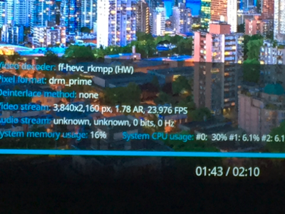

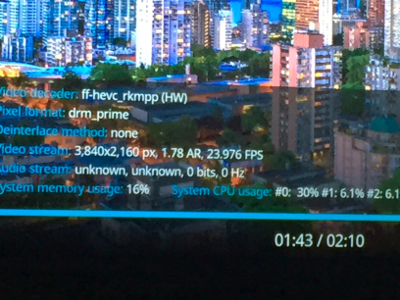

    What would be useful would be to compare frame rate codec information. O on the Kodi keyboard (sorry...if you know) during playback and also confirming the CEC info on your TV. This will at least allow for a common frame of reference ?

    Everything 60fps HDR or not struggles or buffers. (But they do play but loose sound sync) very much like Big Buck 60ftps 2160p and appears cpu related with Core 0 taking the brunt but does not appear to be HW decoding at 60fps. (although rkmpp is in use)
    In short 24/25/30 and some 50fps are fine, 60fps buffering quite a bit with high cpu core values and HLG not working or merde....
