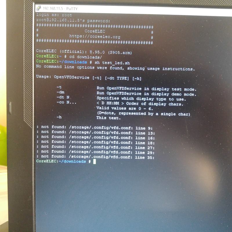

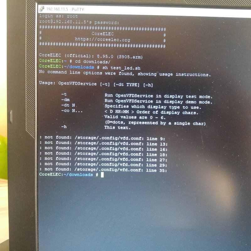

To make the new driver start automatically at boot, this should work:
Codeecho "OLD_PATH=$PWD" >> /storage/.config/autostart.sh echo "cd /storage/downloads" >> /storage/.config/autostart.sh echo "sh test_led.sh" >> /storage/.config/autostart.sh echo "cd $OLD_PATH" >> /storage/.config/autostart.shFor the icons (wifi, ethernet, etc.) enable the OpenVFD Kodi Addon.
That build probably doesn't have the vfd driver, so it won't work.
Sorry, I have following your instruction, but issue still not yet fix.
Can you help me check the autostart.sh file is correct or not?
Note: I already copy the autostart.sh file to /storage/ .config.
Thanks.
Can you tell me how to add it to autostart.sh file?
Because when restart the Box, issue again happned.
Thanks.

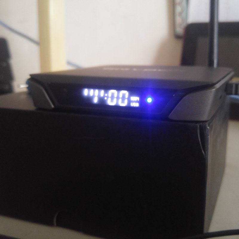

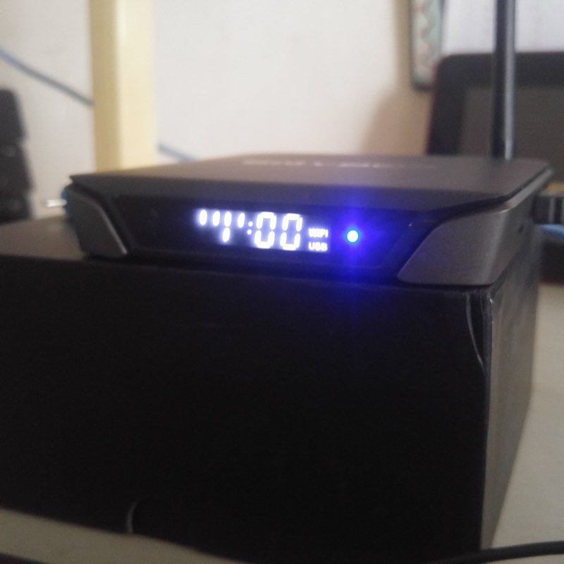

Pls see below for testing result with orginial openvfd.zip:
- The Time display correct with < vfd_display_type='0x07,0x00,0x00,0x00' >
- And another icon like: USB, WIFI ... not display
Ah of course. You'll need an updated driver too. (attached)
You can extract it into the downloads folder for instance, then SSH into the box and start it by running
Use the original vfd from the GitHub repository.

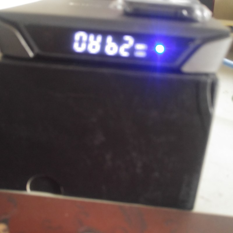

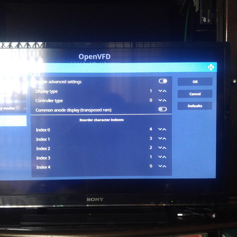

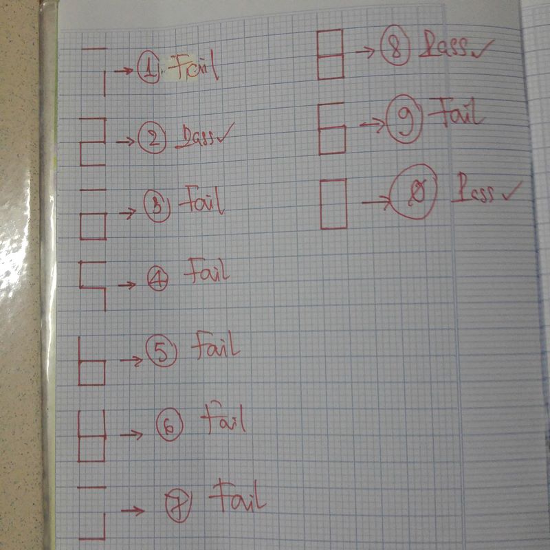

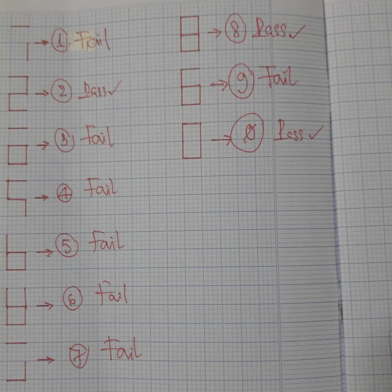

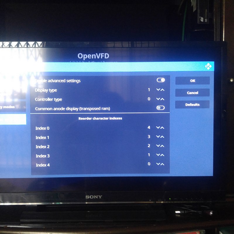

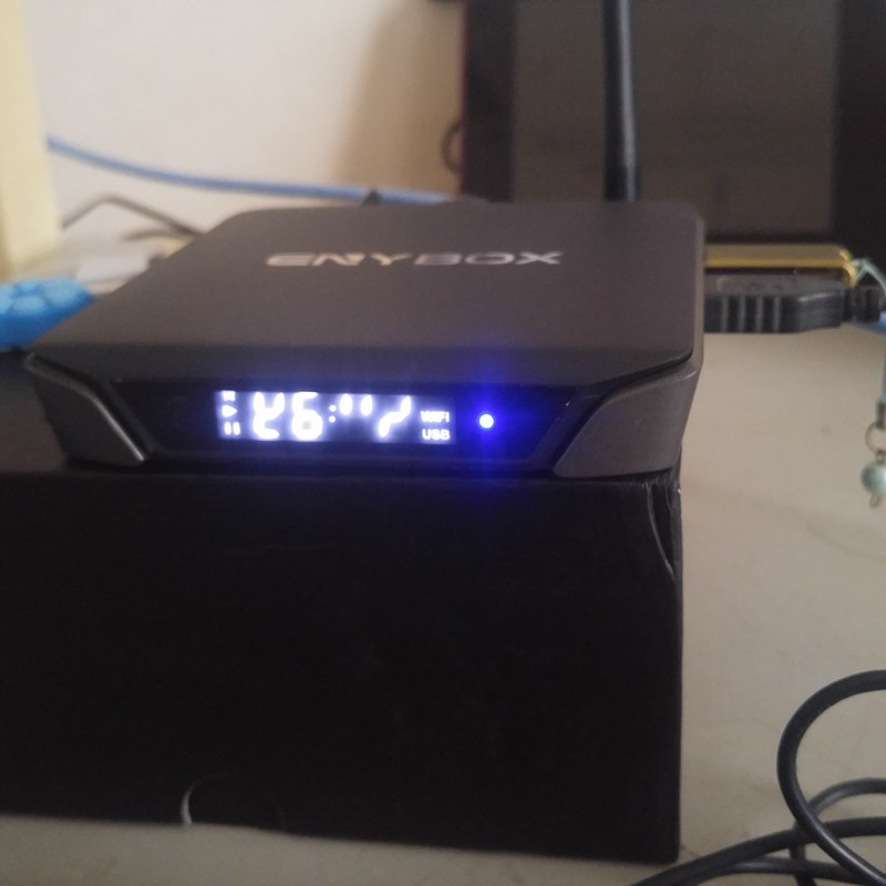

Pls see below for final testing result after disable the advanced settings in the OpenVFD addon:

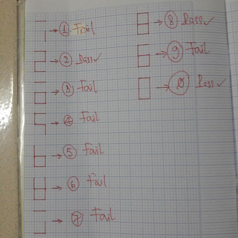

* Almost 4 digits (HH:MM) display not correct the times for numbers from 0 to 9, details as below:
- Except the numbers: < 0, 2, 8 > display correct.
- Another numbers: < 1, 3, 4, 5, 6, 7, 9 > display abnormal.
Pls see attached file and help me fixed it.

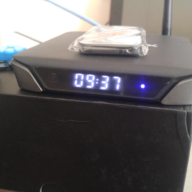

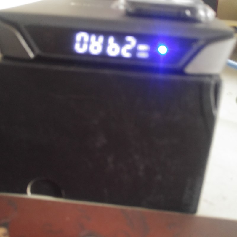

Pls see below for testing result:
1. Using the DTB from the device_tree folder on the SD card name "gxl_p212_2g.dtb" >>> Not any display on the Box.
2. Using the DTB from file attached name "gxl_p212_2g_g9sx.dtb" >>> Have display, but HH:MM display abnormal.
3. And the g9sx vfd from the vfd repository here.

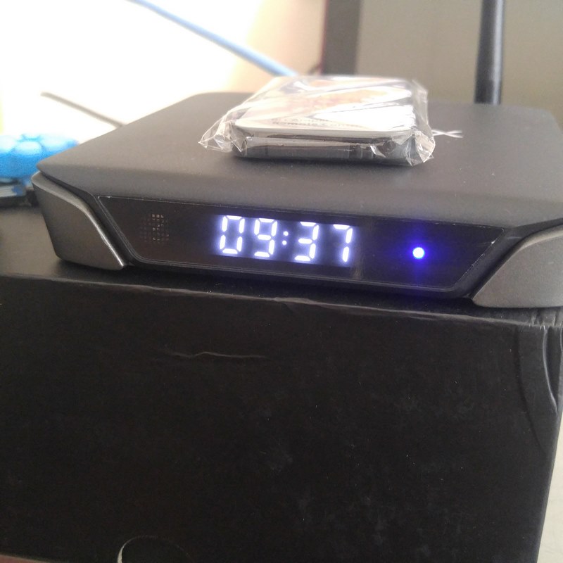

Thank The Coolest for helping me . VFD display on my box Envy X1 is working perfect now
