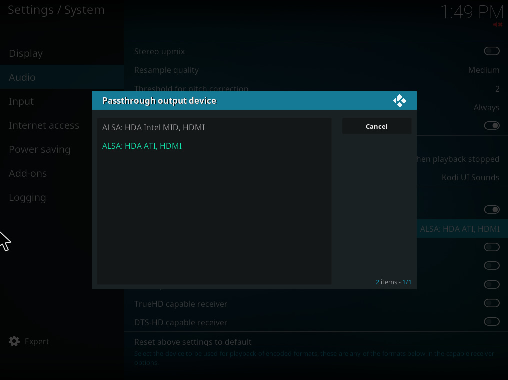

Thanks very much it was muted. I pressed F8 and it now works fine. I was just about to try a different OS to run Kodi thinking that the card was incompatible! Thanks again.
Thanks blueribb
I don't have any other device to test which has HDMI inputs. I've checked the TV settings and there is no audio input settings for HDMI.
I think it's hardware related as there is a red speaker symbol in the top right of the screen in kodi with a X so I think this must mean that there is a problem with the driver?
I've looked through similar posts on the net and some people fixed it using a different lead which I've tried. Somebody else says to disable pulse audio but I don't think this can be done from LibreELEC?
Do you know if there is a SSH command that will work with Libre that will show if the driver has been installed properly?
Thanks
Hi,
Specs are:
LibreELEC 9.2.5 kernel Linux 4.11.12
ASUS P7P55D_LE motherboard
ATI HD 5770 graphics card
I've tried all settings but cannot get any audio via HDMI when connected to a TV. Please see the screenshots for the current settings.
Edit: Not sure if it makes any difference but when I installed LibreELEC I did so with the computer attached to a PC monitor and I then connected using HMDI to a TV later.
Any info appreciated.
Thanks
