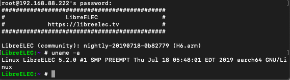

Confirm that latest nightly fixed scattered sound issue with OPi one+, thanks a bunch!

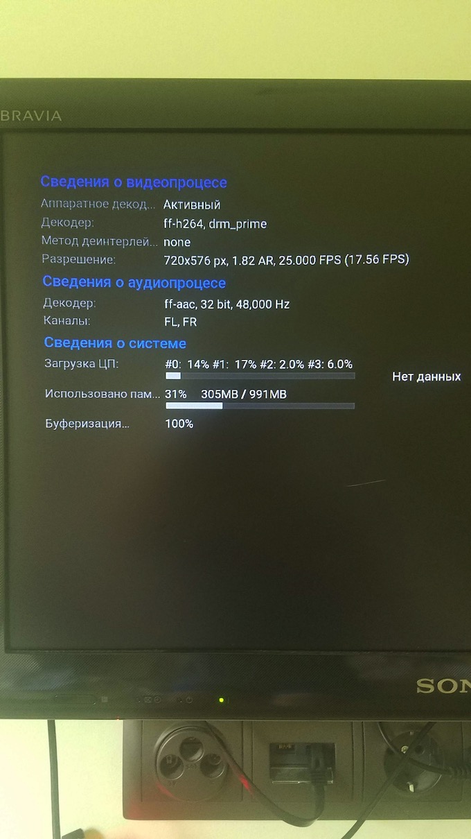

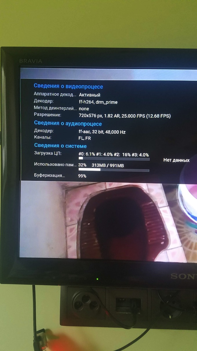

*576 streams don't show the video with OK sound.
Latest couple of OPi One+ (H6) nightly builds are totally broken, no videos are played

* I have 1080 and 720 streams working just fine both HW and SW decoded. 4K and 572 do not work, both give the black screen. 572 decodes the sound OK while 4K does not.
