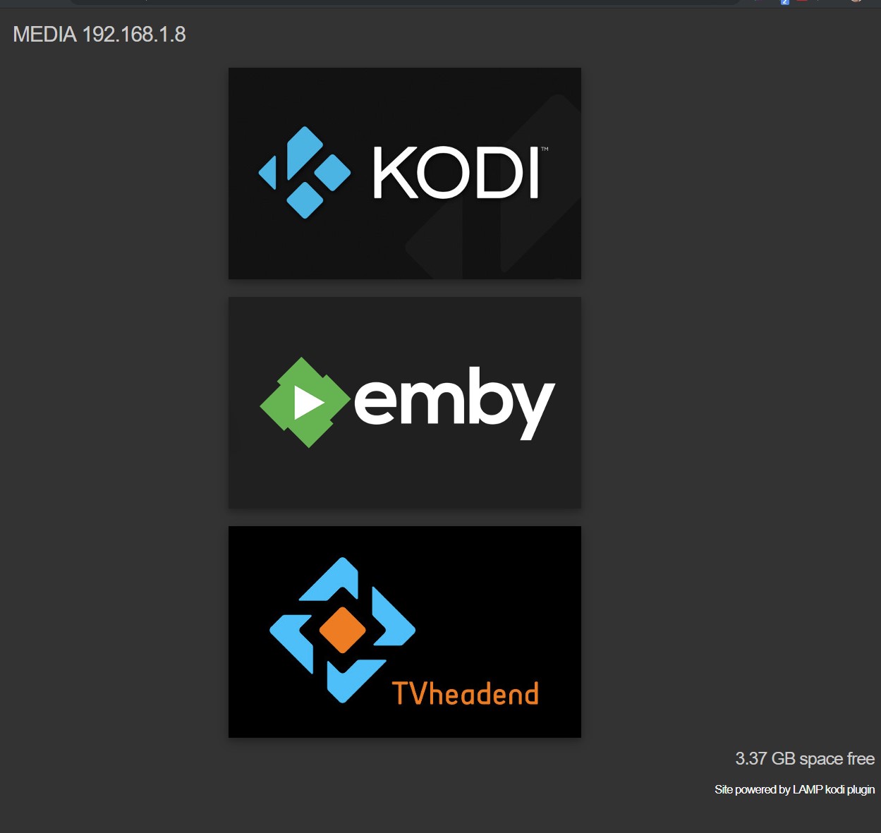

    If anyone is interested. I installed the lamp plugin that puts a web server on port 4080, then updated the httpd.conf to use port 80. (You will need to change the Chrous port if on 80).
    Lamp is available here - Index of /lamp/, install via kodi
    Attached is my simple web frontend.
    Files
    • htdocs.zip
      (58.43 kB, downloaded 201 times, last: )
    I would find it useful to have a simple website on the default port 80 that could have some simple help details and stats etc and can be customised to forward to different web frontends for kodi, emby, tvheadend etc. I'm always forgetting the correct ports for the various installed frontends!!
    Just wondering if anyone else would find this useful? ;)
