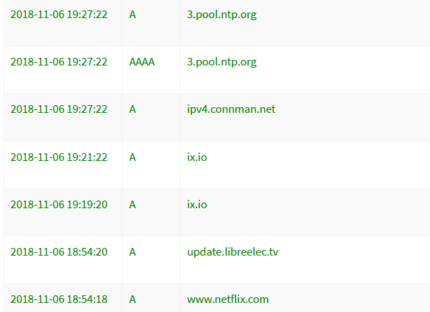

Sorry, here it comes:
EDIT:
out of pi-hole (IP Address belongs to the Kodi player)
EDIT:
I agree. But if there is already a NTP server by your router provided, why not use it.
Even if I use in all 3 Timeserver fields the same IP address libreelec is still connecting to one of those pool.ntp.org addresses.
Hi guys,
I have an issue that I might not understand properly and somebody can help me out with it. I like to use my own NTP Server (Router within the Network) to synchronise the clock of two libreelec installations (raspberry pi - LibreELEC (Leia) v8.90.006 ALPHA and tinkerboard S - daily Jenkins builds). I added under Timeserver #1 the local IP address of my router that is providing the NTP information and left #2 and #3 empty.
I can see now in my Pi-hole that both libreelec installations still connecting to "something.pool.ntp.org" and I do not understand why, since it suppose to take that information from my local source. It works for all other connected devices in my network except libreelec.
Maybe I do understand something wrong!?! Would be nice if anybody could point me in the right direction.
Thanks in advance.
