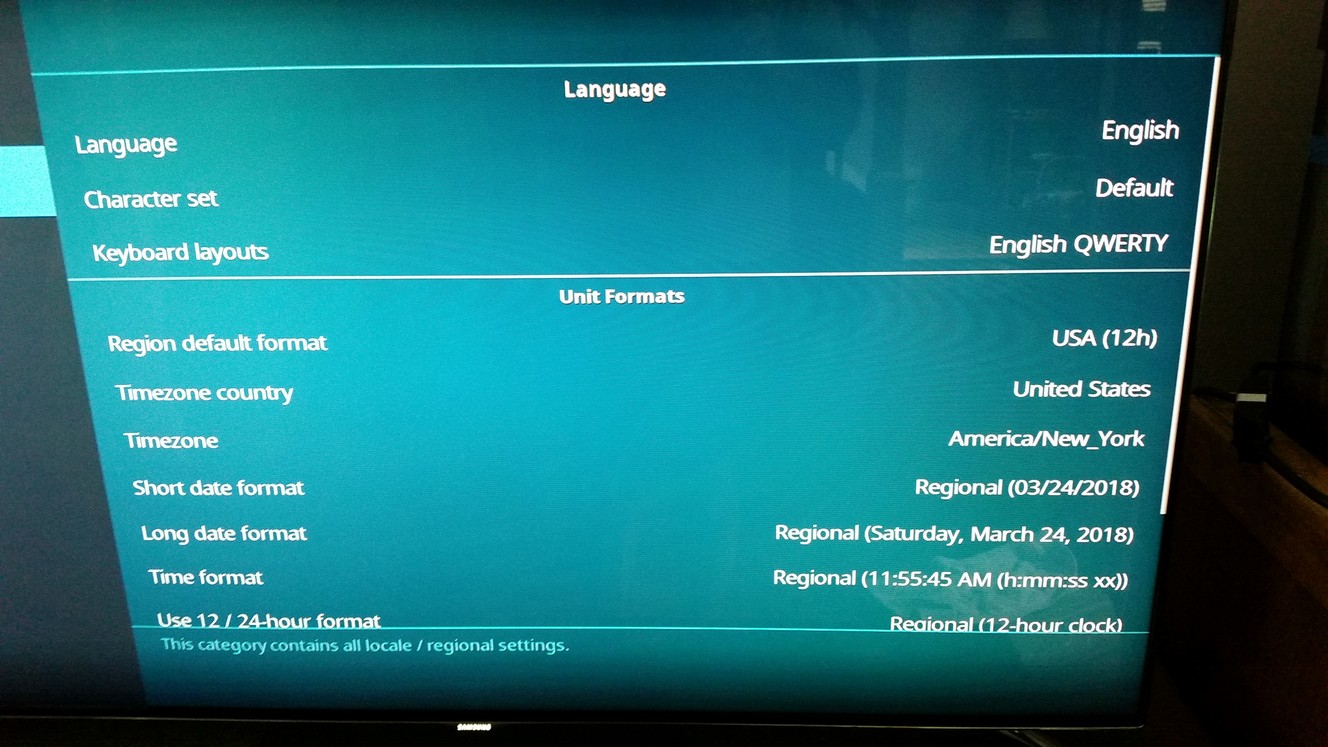

ok already done that. as per attached photos. this a clean install except for video calibration to the screen
SK sorry i don't see your path, but on my Kodi, but attached file to show you my settings, and yes in expert mode.
