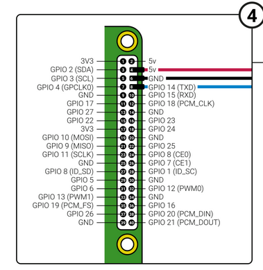

    Hi, I run LibreELEC on a Rasberry Pi4. I use the official fan*, powered from 5V as shown in the attached scheme, and configured in /flash/config.txt to start when 60 °C are exceeded**, which does not happen too often. When it does, it only runs for a minute or so, enough to bring temperature below 50 °C. Therefore, I think 3.3V should be enough for the typical LibreELEC / Kodi use, but as I am not an expert, I'd like to confirm first if this reasoning is correct and if it is safe to do so. I think it should be much more silent (at 5V it sounds like an angry swarm of mosquitoes ;)) and less stressing for the fan.
    And in case any hardware expert reads this, I suppose I only need to move the red cable from Pin 4 to Pin 1, right? As you can see in the second attached image, the black and the red cable end in a double connector, which only allows plugging them onto two adjacent pins, like GND and 5V. So the easiest way is to use two male–female jumper wires?
    * https://www.raspberrypi.com/products/raspberry-pi-4-case-fan/
    ** dtoverlay=gpio-fan,temp=60000
