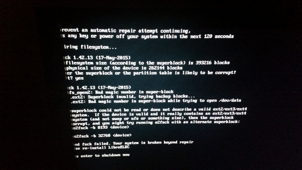

Unfortunetly this didn't work. By using boot to recovery I ended up in recovery menu. And that's it. I coudn't use different SD as I don't have one but I did full scan before burning imgage with Rufus. So that's probably all I can do with v006. I probably try my 'update form zip' method once again but with additional steps with device tree but I think I tried that already. In the worst case I will install Spotify to stream music and Moonlight to check how is going to work with it.

Ok...I don't expect anyone will help me but nevertheless I'll descibe my failed attemps to bring v006 into MXQ Pro Quick Play. As a side note - installing v005 works fine.
I tried all the method...even more then in official guide:- Toothpick - didn't work. Even if there is a switch on the board and it is soldered into it still it won't boot into recovery this way.
- Boot to recovery:
- Android - there's no official option to do that but it's possible through some app. So I did boot into menu but all I've got was message that there's a corrupted file system or something like that. Check attachement to get the idea.
