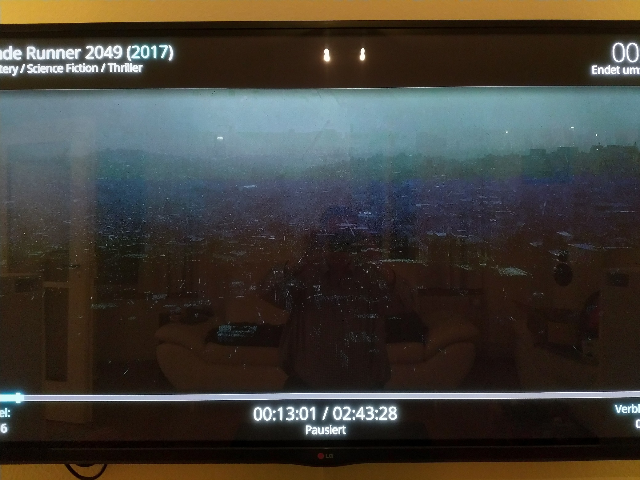

I have tested both AMD Build with an A12-9800E CPU (Radeon R7 GPU), no Hardware Acceleration on GPU for 4K MKVs.
Test with Ryze 5 2400G, the 0927 image is not usable, no Hardwareacceleration at all, on the 0925 Version CPU Usage ist at about 50% by playing 4K MKVs.
Board is an Asrock Fatal1ty AB350 Gaming-ITX/ac with lates Bios.
