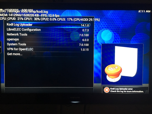

I followed the instructions properly but after clicking YES re "send log to my email" i get kodi upload log error - see thumbnail

i get a fail error when trying to upload log files using kodi log upload addon in libreelec (LE). my micro sd install of LE is only two days old on brand new wetek core. and yes... i enabled debug logging and provided my email address too. not sure why this is happeneing? trying to upload log files as they pertain to another post i submitted today re openvpn.
unfortunately, i failed to enable SSH upon initial LE install so thats not an option. in addition, i may be wrong but is samba only for windows? I'm doing all this from my macbook. help?

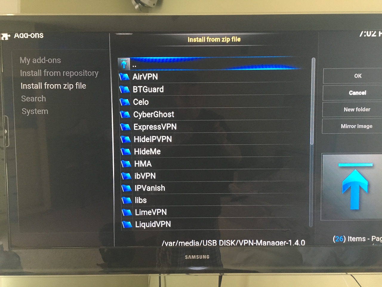

from my macbook, i downloaded all three files from that url and dropped it onto a usb stick then plugged the stick into the side of my wetek core after powering the box off, first.
then I powered wetek back on which loads up the usb/libreelec.
from kodi i went to SETTINGS>ADDONS>INSTALL FROM ZIP FILE.
kodi sees the files but doesn't install or execute them.
is there a certain file I'm supposed to click on?  tried many but to no avail.  arghhh i'm almost there but am stuck!
I've attached a pic so you can see what i see
