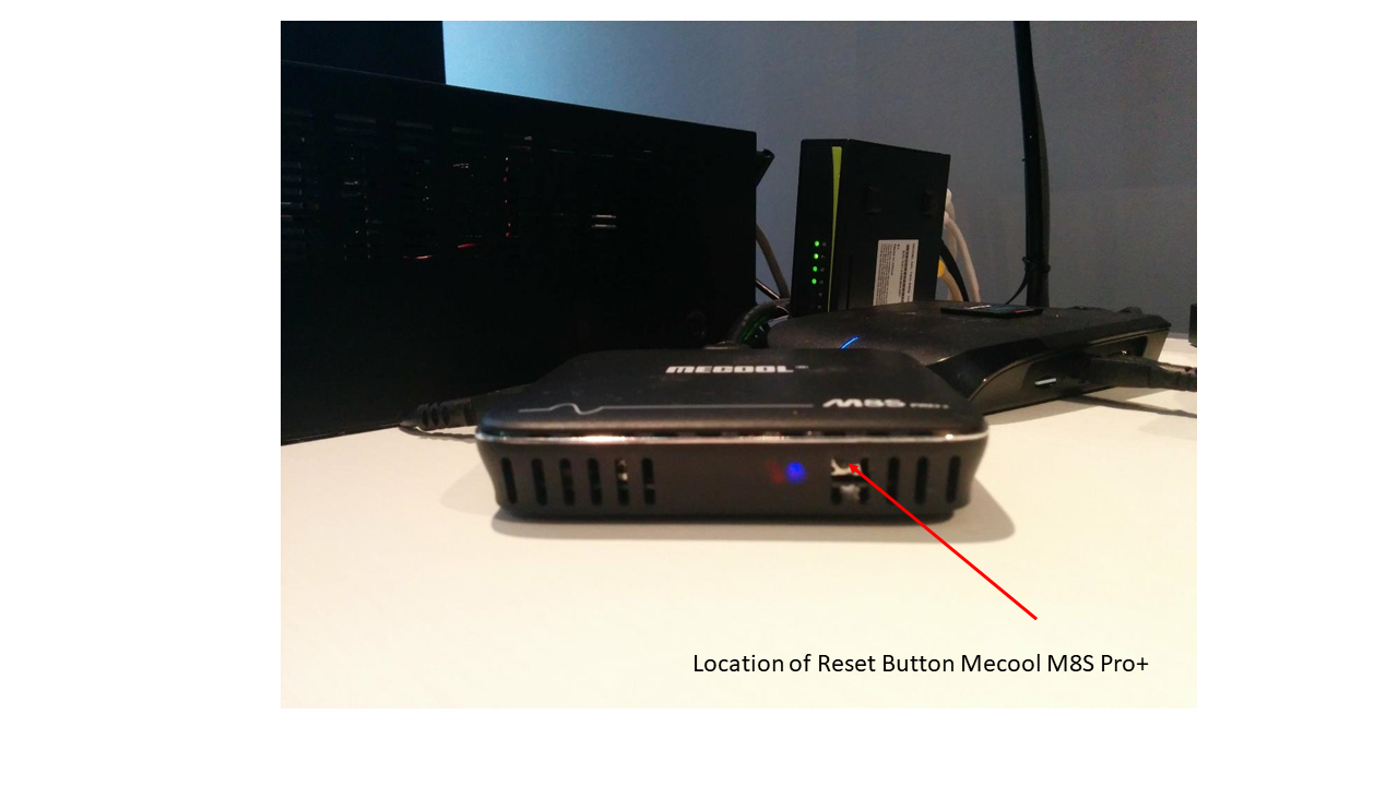

    Here is a picture of the location of the reset button on the Mecool M8S Pro+. Sorry about the quality. The phone camera sucks.
    A toothpick will fit if you remove the first grill post to the right of the power light. The reset button is at the top of the opening you create. You can also poke around without removing the post, but with something slimmer than a toothpick. I found this awkward and difficult without the grill post removed.
    Not all Mecool M8S Pro+ L have that button.
    Mine doesn't so I just rebooted it in Android using ADB or inside Android since it is rooted already:
