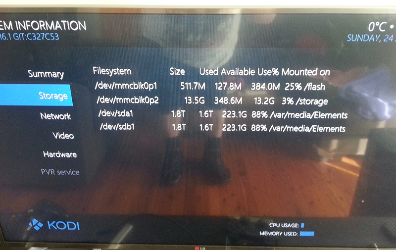

    ***SOLVED***
    Following the recommendations from Milhouse, it seemed to be the very same issue even after renaming the HDDs. So I did a complete, back to SD card, reset and tried again, same issue.
    Contacted Western Digital this morning and was asked if I had purchased the HDDs at the same shop or at the same time, answered yes. Seems this can be an issue even for Windows machines and is EXTREMELY RARE (Im told) - the HDDs not only had the same name but the same internal controller serial numbers on the drives. They provided a software program to run on one of the drives and they work fine now.
    Change of internal serial (RARE!)
    Change of name (Dont know why I didnt think of that myself!)
    And the problem is solved!
    THANKS for all the help!
    Ok so... following the instructions (movies, then TV shows), and issuing the commands requested.
    • dmesg | pastebinit -- KdBT
    • journalctl | pastebinit -- OYQh
    Also find attached a copy of the screenshot of the STORAGE screen from my Rpi2 LibreELEC. When mounting the first drive, the message comes up on the home screen, it does so again with the second drive, but it seems to see the second drive as identical to the first drive?
    For the record they are the exact same model and size drives - both are WD 2Tb Elements drives.
    Thanks, Rich

    Hey there everyone, I hope someone might be able the shed some light for me.
    I have 2 x 2Tb Western Digital hdd connected through a powered USB hub (the powered hub as 3 x USB 3 and 4 x USB 2) and the hub it plugged into a Raspberry Pi 2B - this is the same setup that I had when using OSMC and I never had an issue 'finding the drives' to add TV shows and Movies (one drive contains the TV Shows, and the other Movies).
    Ive installed LibreELEC from scratch and it works fine, added the hdd's to the hub and it seems that only the first hdd plugged in can be found, and only if I search in the "root" storage. I have added the movie hdd, pointed it to the movies, scraped using the movie scraper, everything seems to have worked out perfectly... added the TV Shows hdd, and it doesnt show up.
    Am I missing something?
    • I tried the hdd's in the USB3 and the USB2 - same issue
    • Plug the TV Shows drive and can be found, add Movies drive and wont show.
    • Plug in the Movies drive and can be found, add TV Shows drive and wont show.
    • Tried the 2 x drives at the same time with a reboot, same issue.
    Does anyone have any ideas?
    Will Kodi only look for one hdd? Is there a way to manually add 2 USB drives in some way via the USB hub (I have no intention to remove them and if I do they will end up going back into their own port)?
    Thanks! Rich.
